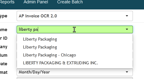

So, when trying to use OCR it’s doing a lookup by name, I have an issue in the best I can do automatically is find the first matching name on these.

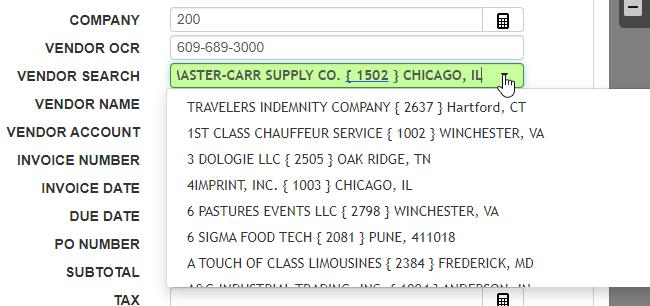

You can make a view and then have the company and vendor appended with Pipes and then use SPLITGETREV on the delimited values.

We do the same, but we add City/State to it. We use a view inside the IDC database whose source is the Epicor Vendor table. It brings in Company as well, which allows for our M/C validation lists for vendors.

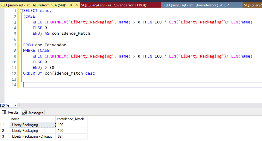

One of the things that I think I’ll try to implement on some level is a “confidence match” based on various factors, like name and maybe some other things like address. Then do a count of matches over a certain threshold, and if it’s more than 1, then make a soft validation in IDC so someone has to validate the higher number that they picked the correct one before it moves on to EDC. I don’t want to have someone look at every invoice that comes through because some of them might have a problem. Then won’t get caught it its 1 out of every 100 invoices. It’s too hard to stay that vigilant.

Ah, you made the confidence interval field haha I thought they had that field for each run they had through their recognition.
@utaylor , this will blow your mind too. I started a class on copilot usage (I’m like 2 videos in lol) but it opened up the possibilities of using the co-pilot chat and asking it to make things for me. So I just made a sql file and asked to try to do some sql code for me and it’s how it came up with this. This is like using chatGPT to write your code, but on steroids because it can look at what you already have and extrapolate from there.

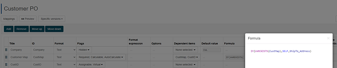

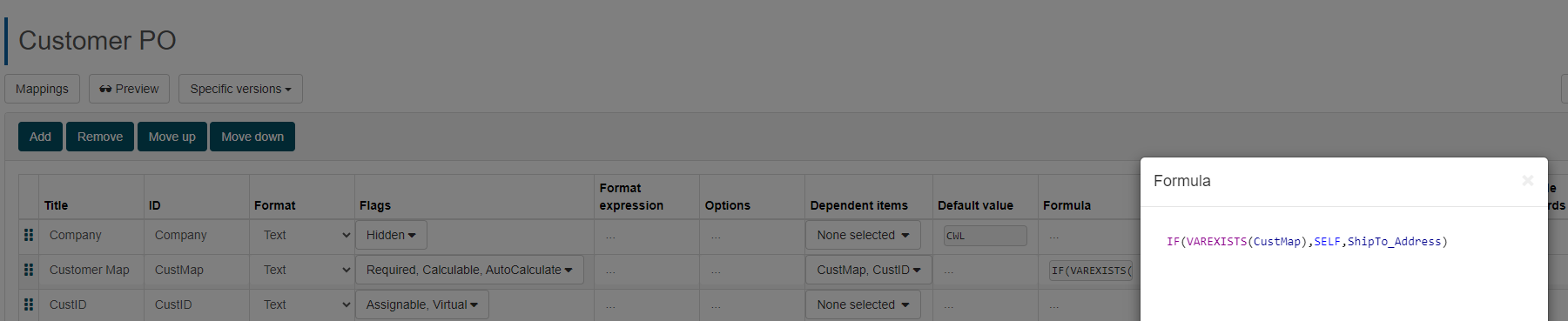

Our Sales Order Automation has a field called Customer Map where you can select a field from the Customer’s PO that determines the Customer ID. In our case, the shipping address gives us the Customer ID, so I have used a formula to copy the Shipping address into the Customer Map. Then I put the Customer ID in the first time and those 2 fields are now linked. Whenever that Shipping address is found in the Customer map, the Customer ID is now entered.
