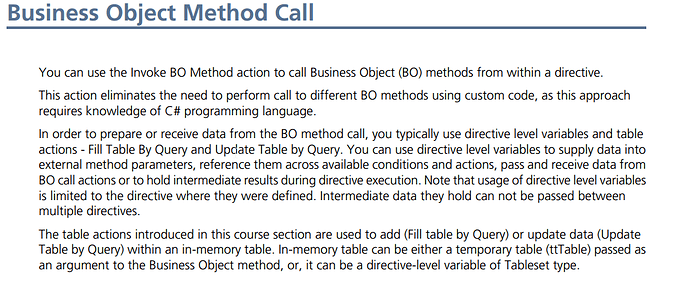

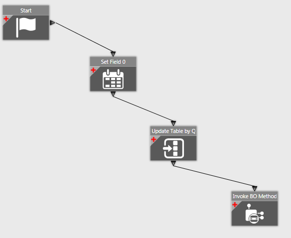

In the Advanced BPM Embedded Education course there is a workshop that uses “Fill Table By Query” and “Invoke BO Method” which is what you’d want to use in an MT environment as they are purely wizard driven events.
EDIT: There is another post from last year that discusses update table by query with a couple of working examples:
