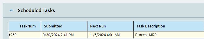

Ah…we have EpicorICETaskAgent4.2.400 running on our app server and the times didn’t adjust automatically. OK. I just manually edited the next-run times and saved each affected task. We’re basically a Mon-Fri operation so it really didn’t cause a ruckus.

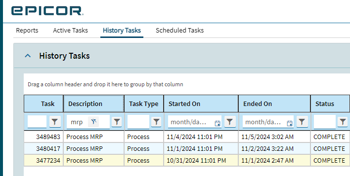

However, I am happy to agree that its schedule did adjust for DST. ![]()

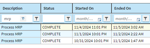

Ironically, though, my dashboard now lies for last week because it calculates the offset based on the current UTC offset.
(MRP began for me at 11PM all 3 times IRL, despite what this dashboard looks like.)

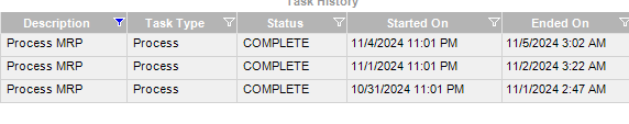

The real System Monitor gets it right, though (11 PM all 3 days).
How does it know?
What about sys mon in browser, what time does it show?
It’s right.

Technically, if you provide date in UTC then for specific date time should be adjusted correctly, because for that date DST was used.And database just stores UTC datetime.
How do you create dashboard, do you do anything with date there? What does underlying BAQ show?
DATEADD(MI, DATEDIFF(MI, GETUTCDATE(), GETDATE()), SysTask.StartedOn)
Borrowed from: SQL Query to Convert UTC to Local Time Zone - GeeksforGeeks
Also, I never spelled this out, but I convert it because if I do not it will display as raw UTC.
For example, I am lazy and never fixed this portion of the dashboard - this is the task which runs at 11 PM in this time zone. It displays as 4 AM.
