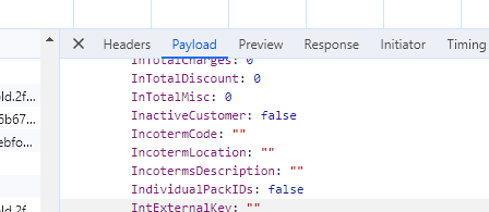

Order entry works fine but our service connect workflow that calls the MasterUpdate method is failing because IncotermCode can’t be null. I don’t understand why we should be forced to pass in an empty string to a field that is not required. I can see that when the UI calls the master update method, that is what it is doing (passing an empty string). But there are other fields in OrderHed we don’t have mapped in the service connect workflow at all and none of those cause a failure. Struggling to understand how a field can be required but not required.

I suspect the field is setup on the Db as notnull passing an empty string should fix it

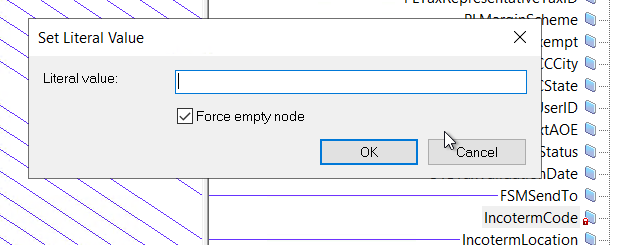

Par for the course when it comes to Service Connect and upgrades… During an upgrade I just go into every SC workflow conversion node and drag the lines over for any new field that shows up in the dataset… you never know when there is going to be some code that trips up over nulls…
So interestingly, assigning a literal empty string to IncotermCode works, but assigning it to IncotermLocation still fails. But in the UI the incoterm location field is disabled so its even less logical for that field to be required.
I’ve tried a string functoid and having that be “” and I’ve also tried setting the literal to “”. Do you perhaps remember how you resolved this error? Thank you for your time.
Read the Activity Log wrong. Doing below worked. One of my conversions wasn’t wired back up after I did below. So the value was lost.
