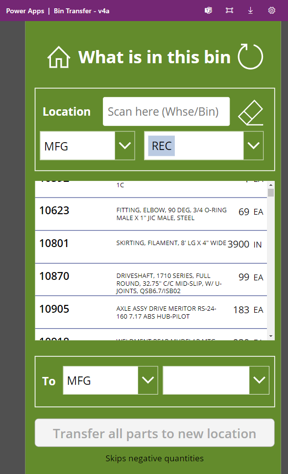

I had built that into my Power Apps app. It was a request here, too. We seem to tear down shelves and move/rename them pretty often.
I can handle loops in Power Apps. Not as much in Epicor.

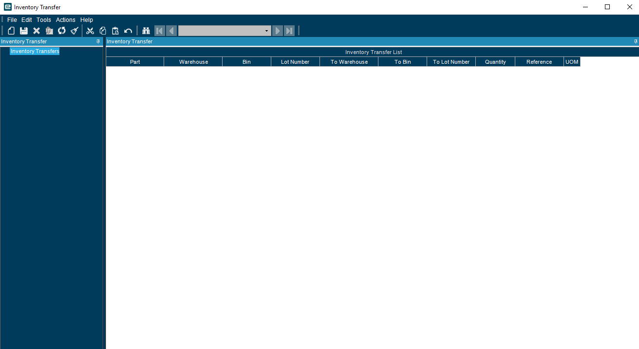

Have you tried using the List view of Inventory Transfers. You can paste-insert into that grid and assign new lot numbers as well as the from/to warehouse/bins.
