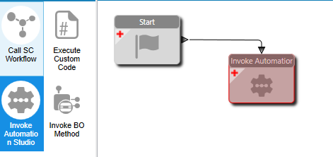

Anyone have the underlying c# code the Automation Studio BPM Widget uses?
Does anyone have the underlying C# code that the Automation Studio Widget inside a BPM uses? I’m on public cloud and don’t believe I have a way to dump the underlying source (If there is please let me know!). I want to iterate over the widget but I don’t really want to have to wrap the automation studio call in a function that then makes a web request if there is something already prebuilt. Thanks.
