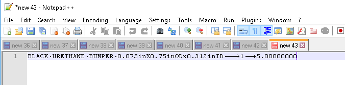

I am using notepad++ to show all characters so I am pretty confident the control characters are being transmitted.
as you can see the tabs are shown as an arrow.
