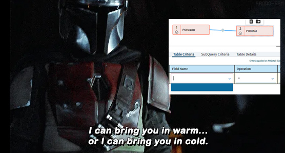

  • In table criteria, the field name drop down menu comes up blank, i would have to refresh a few times or just click around, eventually it will populate.
