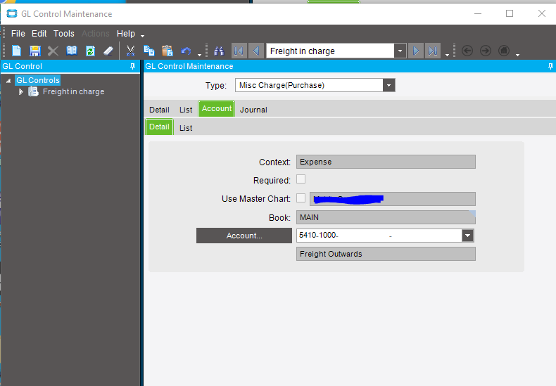

For Misc Charge on Purchases, check the GL Control Maintenance to see if the Account for your Misc Charge has a Control. I think everything will balance if the GL control are set correctly.

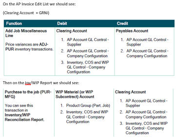

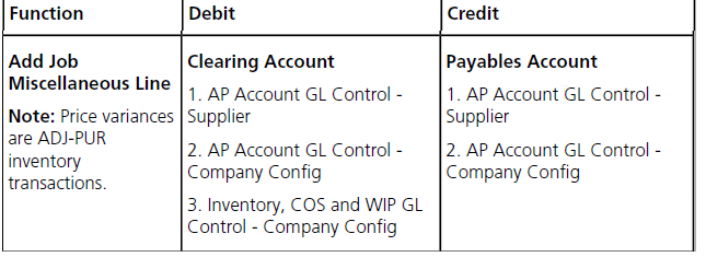

Even in the Hierarchy document, it goes to the ‘Clearing’ account’. Not sure why it goes to the clearing account when it isn’t a GRNI but an invoice. If I change the clearing account on the AP Account to be WIP then when I do have a Goods Receipt Entry, that will also go to WIP!

Epicor has a complicated cycle on AP invoice jo charge, what it does is, on the AP invoice it goes to the clearing account when you do the Job charge, once this is posted and you run COSWIP it moves from clearing account to JOB WIP.
Thank you. This was the trick we were missing. Would be nice if this was in the Hierarchy document!
It’s in the hierarchy document, just read down a bit after the section you already posted:
