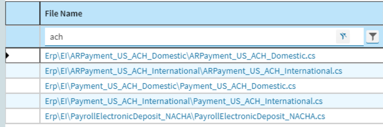

I cannot use the INternational - error about banks only outside the US.
I cannot use the US_ACH_Domestic - CCD only
I cannot use the PayrollElectronicDeposit - No error nothing happens

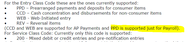

I have heard you can get the file from the cloud team. PPD is done but only for payroll.
https://epiccare.epicor.com/epiccare?id=epiccare_kb_article&table=kb_knowledge&sys_id=55d352ffdb8b40500c3f9b3c8a961907&searchTerm=ppd
https://epiccare.epicor.com/epiccare?id=epiccare_kb_article&table=kb_knowledge&sys_id=f235c02d1bbf91182f083112cd4bcb12&searchTerm=PPD%20ACH

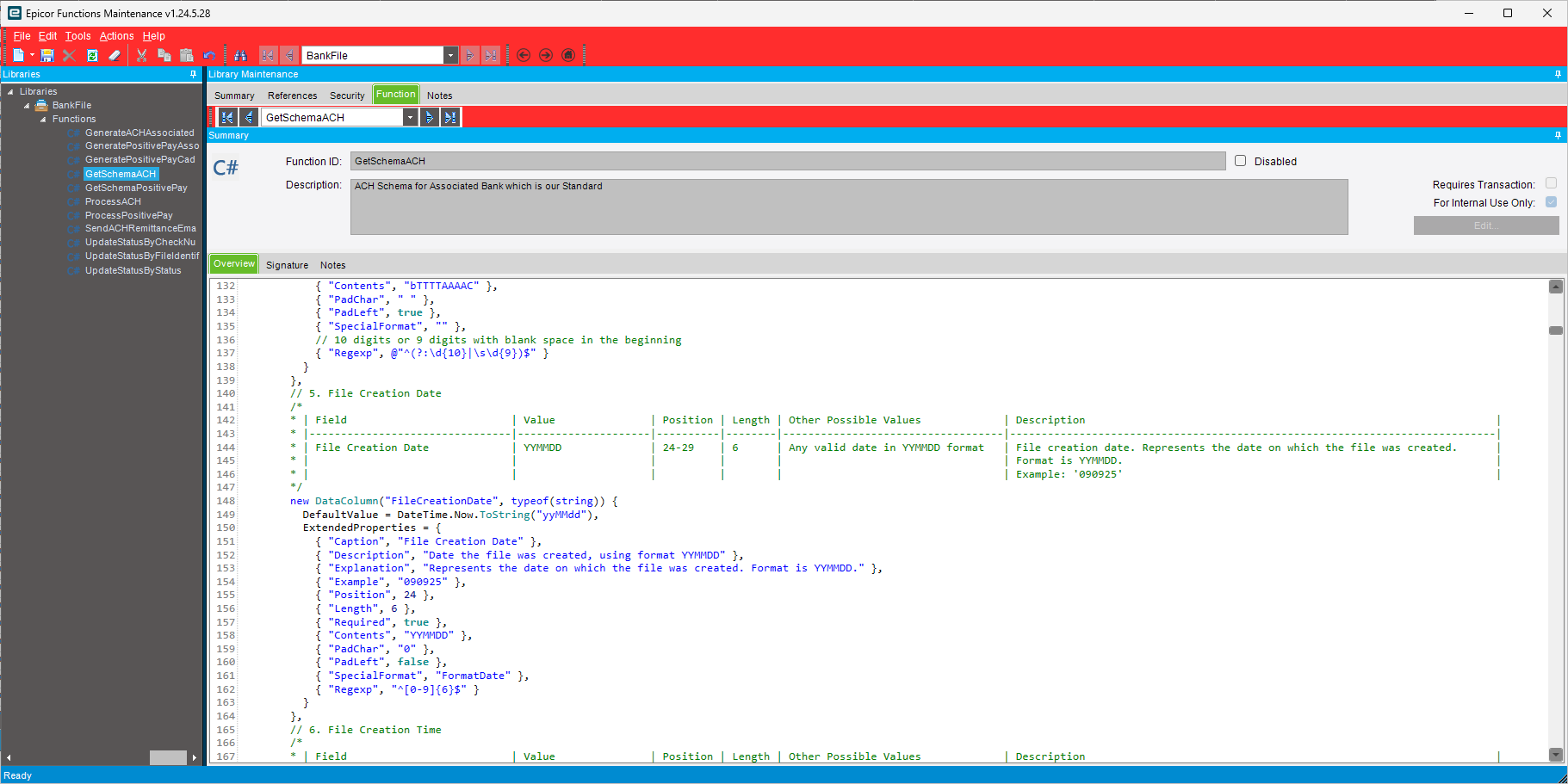

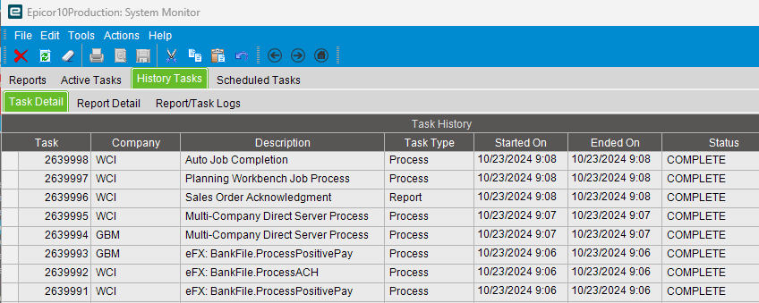

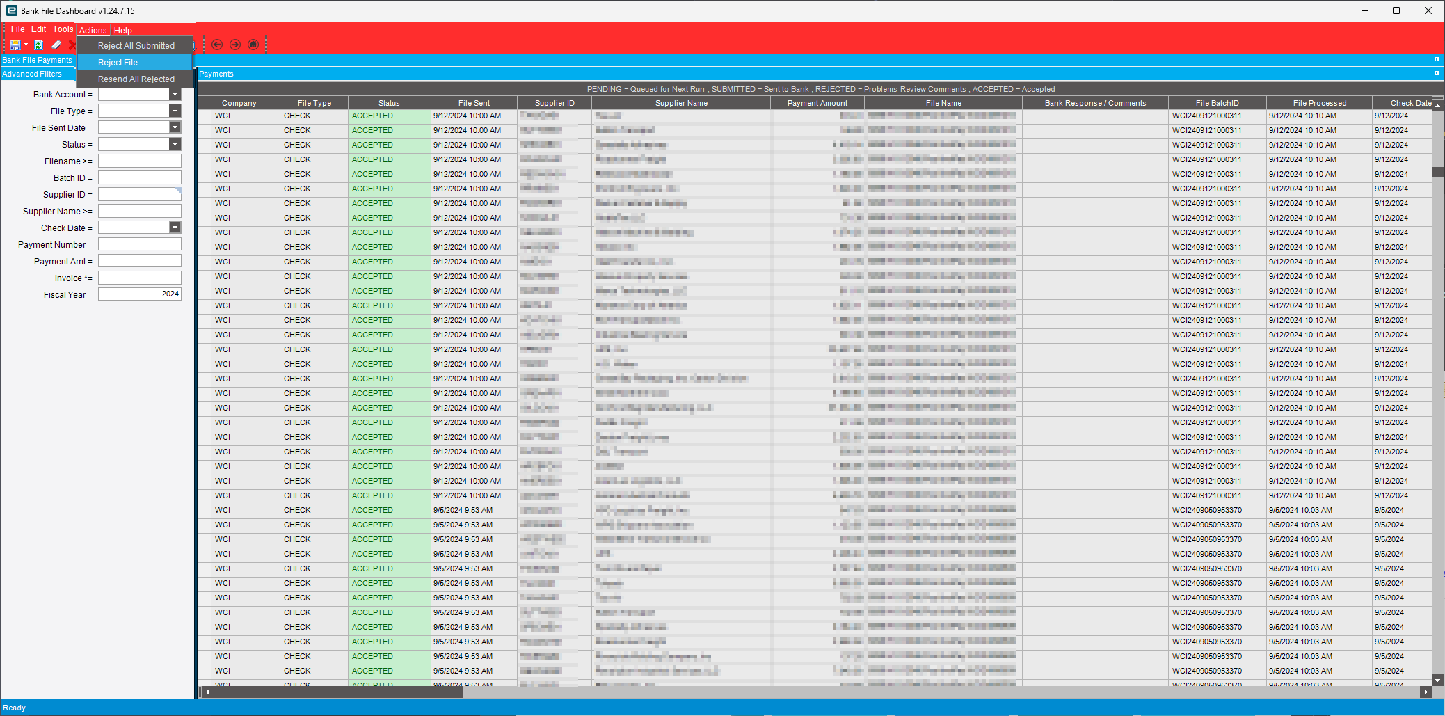

All of Epicors Electronic Interfaces are just blah. I just spent 3 months building ACH CCD, PPD, WEB, CTX in EI and Functions, once I built both we decided to just do it in Functions because an EI runs during Payment Processing and there is 0 guarantee that the file is accepted by the bank, and you may want to read a response file which may come 15 minutes later. You are stuck holding your group hostage (not posting it) until the Bank Accepts the files, otherwise you go into VOID hell. You also might want to configure SFTP Upload among other things which Epicor doesnt support out of the box.
TLDR; We did EFX and Dashboard.
Maybe this inspires the next generation @JeffLeBert to use EFX instead of EI :slight_smile: oh did I mention that I simply get my data via a BAQ. Forgot to mention to be able to label the EFX via Process Set got a SQL Script on-prem but will make an idea for that too!

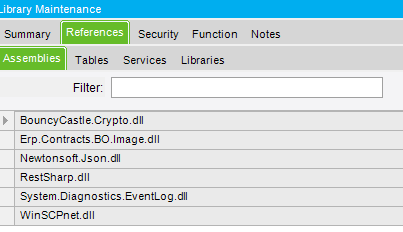

This is a good example @Epic_Santiago why for example on-prem limiting File.Write via Sandbox to certain folders is bad, because we have other processes that pickup and move things via SFTP just because you dont have things like that in the cloud, shouldn’t stop the on-prem folks of utilizing C# we are on-prem and paying for an on-prem license. :slight_smile: perhaps consider a whitelist vs limiting it to Company ur User Folder. Some write or read from/to \\UNCPATH\
When folks say they save money being on the cloud, they forget how much time they waste working around limitations. You saved on hosting but I can do in 30 hours what takes you 130 with workarounds. :stuck_out_tongue: technically I saved more than you in the long run. We just added WinSFTP.exe to our Custom Assemblies folder and SFTP is ready to go, no micro-service needed.
