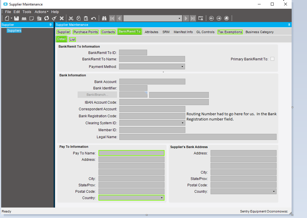

It was the Vendor Setup… Strange that the error was COMPLETELY not helpful.

Now that the Vendor Setup is correct…
