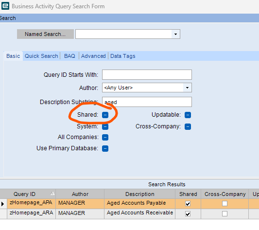

Hi David,
Thank you for your reply. I have searched, but we do not have zHomepage_APAgedPayables in the list of system query’s.
Wow. I had assumed a system BAQ would be on everyone’s environment. Are you including shared queries in your search?
Not doubting you… just a little shocked.

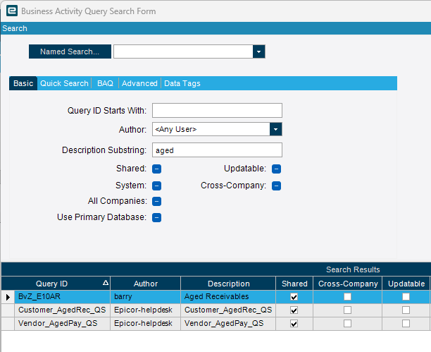

That is the first thing I do :grinning:. But check below screenshot.
image.
Is it possible you send me a copy?
Perhaps they’re country specific? Or perhaps they’re linked to a specific module? Dunno.

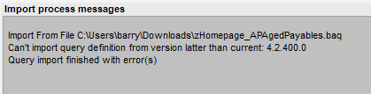

Thanks, but I get a error message when importing.
I think that is the reason we do not have this BAQ.
Well, I don’t know that its a new query… its just my instance version may be later than yours so it won’t allow you to use it.

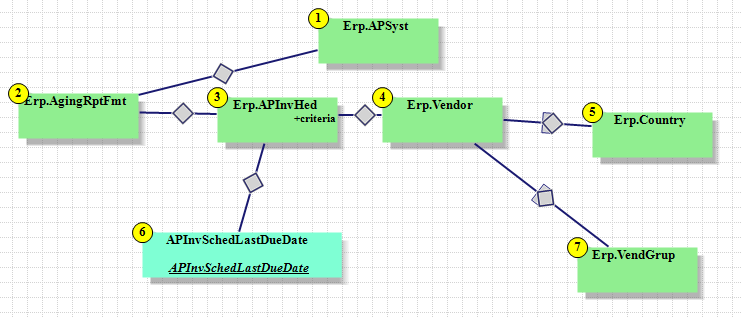

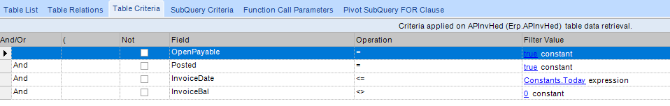

Let me take some screen shots, if you wish to recreate it.

Query List:
CTE Query:
TOP LEVEL QUERY:
Criteria on APInvHed:
Display and Calculated field details would be in the above posted query code.
