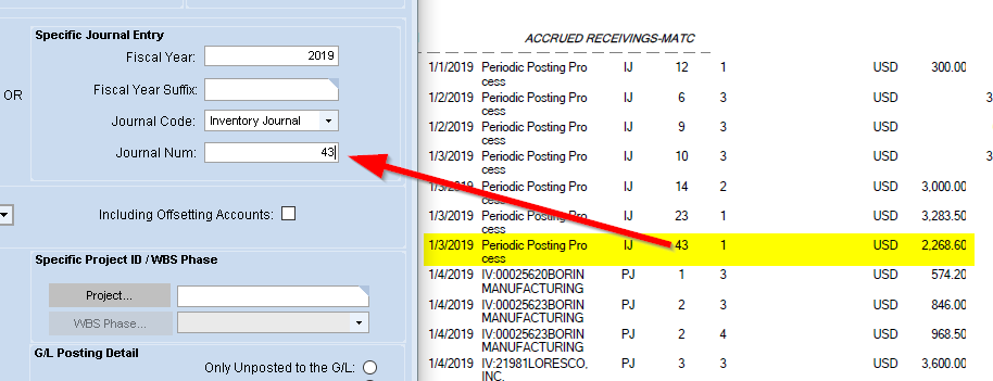

You can see the specific transactions that make up a “PPP” entry, by running WIP/Recon using the Journal info from the GL report
Sorry, I got pulled away.
Following your instructions on the GL Report, it appears the transition, in that period, occurred after the last PPP. There were 17 more invoices posted to that period.
So invoices started to exceed receipts?
What I would do is export the GL Report for that Acct, and then the same for WIP Recon(just that acct, no offsetting accts). Then try to match up the PUR-xxx lines to Invoices

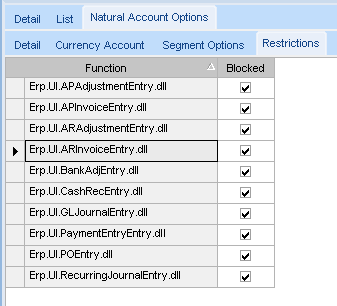

If there are no manual GL transactions against the account and the AP Clearing account is not on any other GL Control Code, then there are 2 ways other ways this could get out of whack. First, all control accounts like Cash accounts tied to Bank Accounts, A/R Trade, Unapplied Cash, All Inventory accounts (including WIP), A/P Pre-Payments/Advance Payment, A/R Invoiced Deposits/Pre-Payments, A/P Trade, A/P Clearing, and Retained Earnings, should have Restricted Functions tied on those Account Segment Values on the Natural Account Options > Restrictions sheet:

If you put in Account Restrictions and ensure that they’re not using the Unreceived Lines option, I think you’ll have better controls in place.
