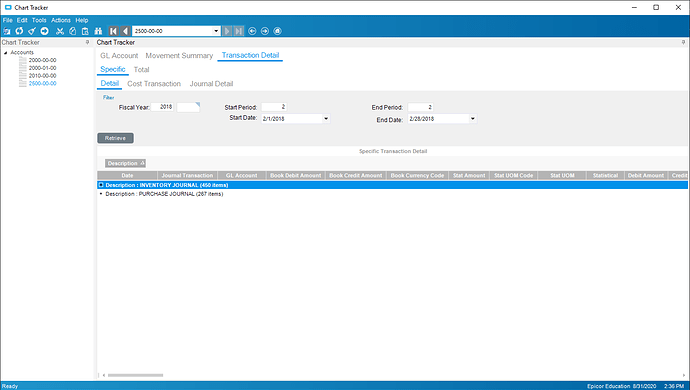

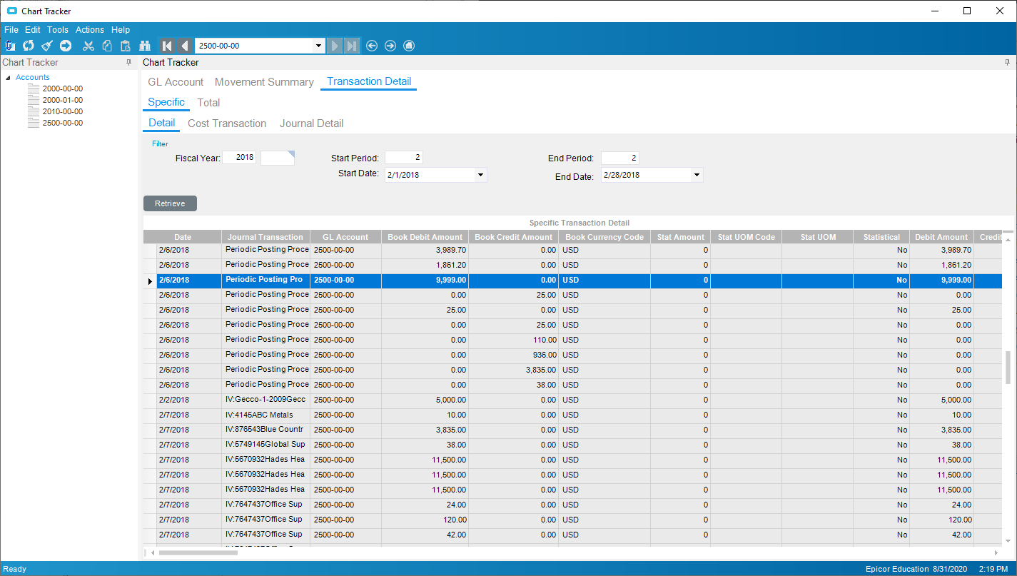

I would start with the Chart Tracker. In general all the debits should be tied to an invoice and all the credits should be “Periodic Posting Process”. You can see the details of the transaction on the cost tab or with the INV/WIP recon report. For a BAQ you would start with the TranGLC table and join to partTran. (There should be a post on doing that)
You can also look through your GL control codes to make sure that a different AP clearing account isn’t assigned for some situations.
Also group by your Journal Transaction. I would expect only two types.

So use the Chart Tracker, and check for any entries not from the IJ or PJ.

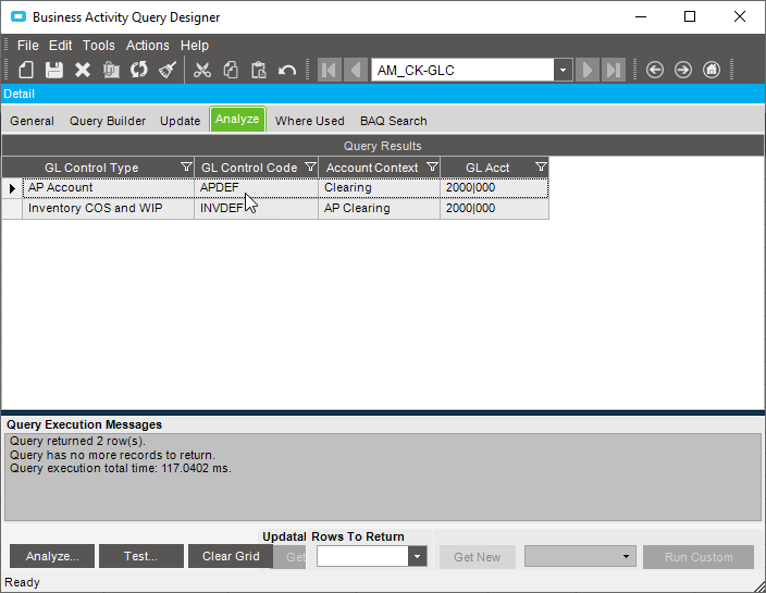

Luckily, I created a BAQ when you helped me before on a similar check. I show that I’m only using our account 2000 in two places. GLC AP Account and Inventory COS and WIP.
Would this be correct?
And they’ve been that way since day one?
Any where else that Acct 2000-000 is being used?
Also, only 2 GL segments? (Making sure you’re not multi-site, and dynamically setting the Div segment)

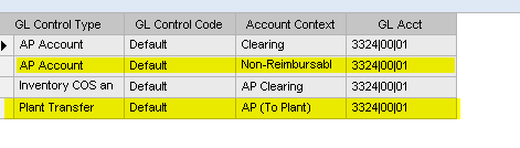

I just checked to see what GLC’s specify our AP Clearing acct and found two I wasn’t expecting:

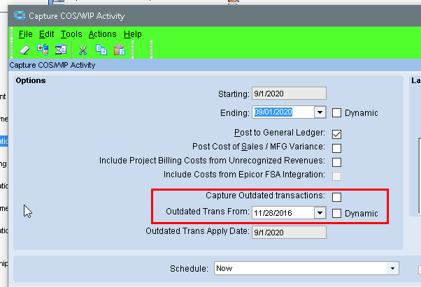

If the dates are in closed periods, and “Capture Outdated Transactions” is not checked on the “Capture COS/WIP” program when it is run. Or if it is checked, but those dates precede the "Outdated Trans From: " value.
If either of those cases exist, then there could be unposted transactions.

What does the GL report for that Acct show? Anything besides “Periodic Posting Process” and the individual Invoice postings?

If you run the GL report for that period, you can see when the running balance changes direction. And whether it was PPP trans (from Capt COS/WIP) or AP Invc posting.
