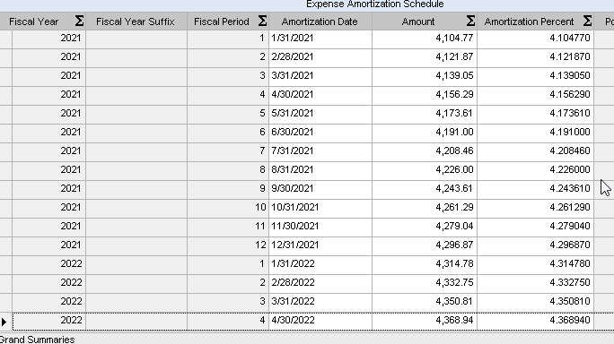

After letting Epicor do its thing of splitting each equally among the number of payments, go back and update the Amotization Schedule
Here’s the Principle line’s Amort schedule updated:
I calculated the Amort schedule in Excel using the PPMT()
and IPMT()
functions. PPMT calc the Principle portion of a payment, and the IPMT the Interest Portion.

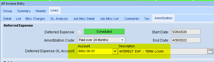

- You can set the GL Acct to use for each line. (each invoice line, not amortization line).
Here’s the test I dis for the Interest line:
