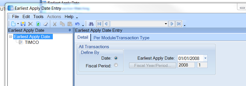

On the earliest apply date set up screen did you check on the detail tab to the right side that breaks out AR, AP, etc?

that screen shows the OVERALL EAD … you 'll need to check the TAB for
PER Module/Transaction type … for a specific AP EAD … which precedes the Overall EAD
this is what Brad was speaking of
