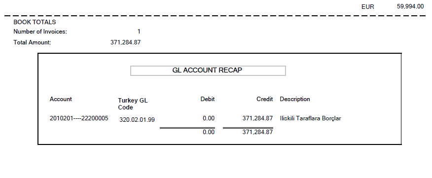

There is only credit amount appearing while there is no amount or GL details appearing for debit side.
What type of purchase was this? If it’s inventory do you have an AP clearing account and is it on the Inventory COS and WIP GL Control?
The debit would be the expense / inventory account. You could have an invalid account on the part class, vendor or inv-cos GL Control. Does the invoice show a GL distribution?

Miscellaneous invoice / no inventory for this company
