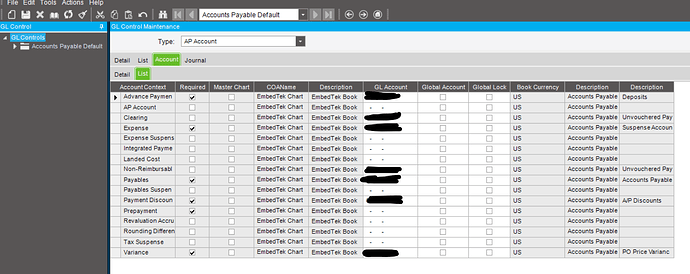

They are getting an error when running the AP Invoice Edit List: Post Rounding Difference to Rounding Difference Account: Rounding Difference Account is not defined in company AP Account GL Control.

EpicCare article says to make sure the rounding difference account is filled in for the GL Control. Even though the round difference account is not a required field. Which we can enter, just looking for a bit more information on why its needed; if there is any.
Is the Rounding Difference Account flagged as required on the GL Control Type? If it is, maybe turn it off and see what happens? :man_shrugging:
Not flagged as required.

Almost like the new code is doing a check for an issue before there is an issue. Seeing if anyone else has seen it. The “fix” is to just put add an GL account. which we will be doing. Just very odd.

Check the Book master for GL Account setup
Yes, adding the account gets the Kinetic Process to work.

Guess we will just let it be. We haven’t touched those settings since initial set up in 2014, odd that a field is required when the required checkbox isn’t checked and in the Classic version it works.
