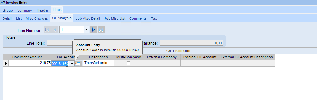

10.0.700.4 - When changing the GL account on a line in GL Analysis, we see an “Invalid Account Code” message. The account exists, is active, has no eff/obs dates. If we change the department, it will accept some, but not all of them. Is there a place that goes deeper into why E10 thinks it’s invalid?

Just a SWAG … have you tried to REBUILD the GL ACCT DISPLAY?
I’ve seen this before where I had to go back into GL Account maintenance
and “re-add” the GL account and save it.
Also check your segment values to make sure they are valid for each of
those segments
