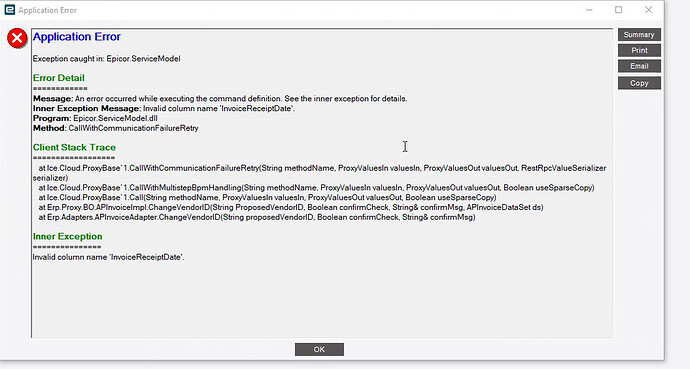

We are experiencing an error when selecting a PO in AP invoice entry, we get an error I
“InvoiceReceiptDate” unavailable,. We don’t get that error in the earlier version, or the current demo database version. So all I can assume is the field is part a data view on the ApInvoice. As a result of the conversions not running completely, we are getting this error. I have been td we have disabled any related Bpms, but the errors persist.
I’m open to suggestions…

The error was this when either adding a PO or a Supplier to an AP invoice.
Resolution was to enable BPM logging on the app server and then review the log after replicating the error.

it was this line that gave it away:
Extensibility.CSF.Australia.APInvoiceExtension.GetBPayData(APInvoiceTableset ds, APInvHedRow apInvHedRow, Boolean createExtRow)
at Extensibility.CSF.Australia.APInvoiceExtension.AfterMethod(String methodName, Object response, IDictionary`2 parameters)
hope it helps someone…
