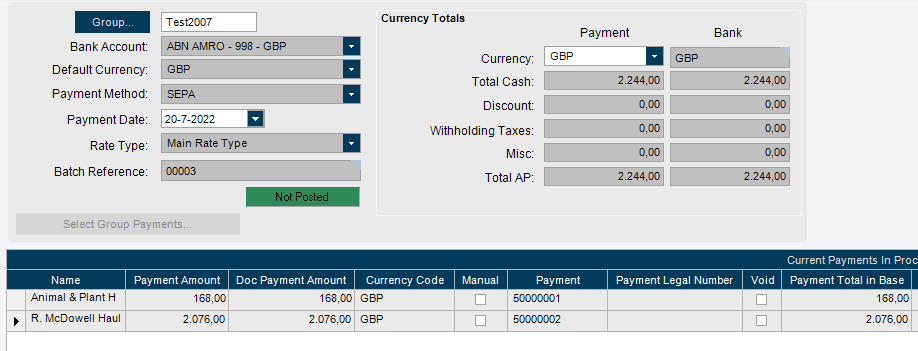

When I am testing a payment entry, everything seems fine until I want to process the payment. I have created a .xml export file and press generate only. Nothing happens and when I check the system monitor the following error appears on my screen:
“Currency ISO code of a processed payment transaction is GBP. Selected payment transactions must be in currency EUR.”

Are you selecting GBP as the Payment currency in the Payment Group?

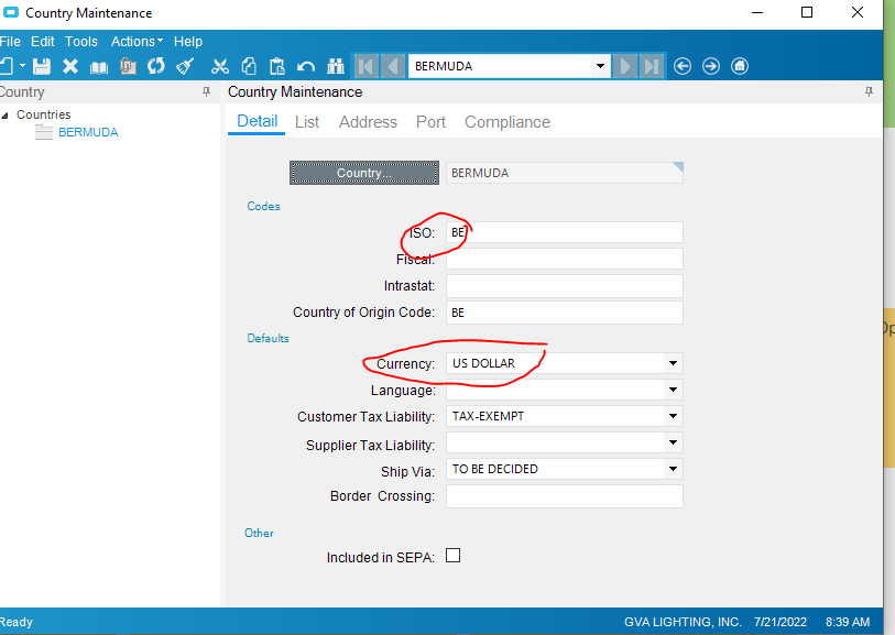

The ISO code is related with your country setup and the associated currency with that country.
I don’t usually setup country currencies since I don’t want to limit my use of currency depending on geographical location, but seems like is your case.
