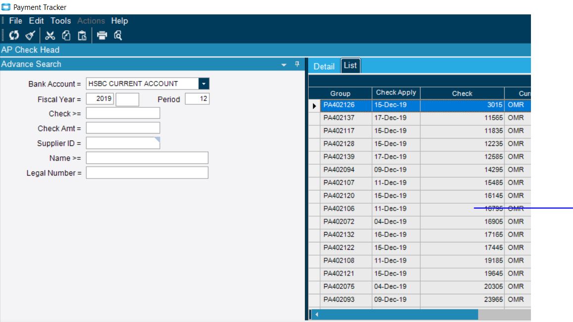

Dear Experts, How to view attachment of posted payments in Payment Tracker.

I have attached some documents in Payment Entry & posted the entry. Now how to see those attached documents in Payment Tracker?

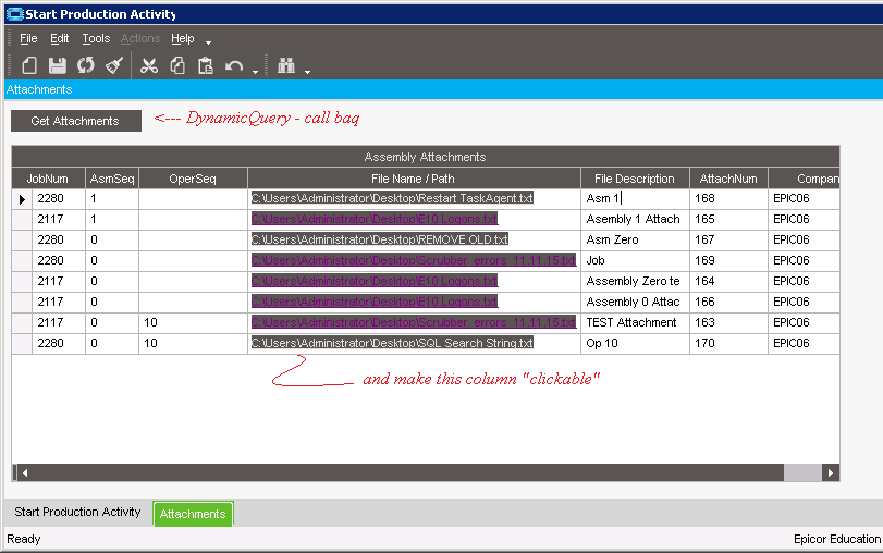

If you just want a simple list - I’m thnking you could build a BAQ and then customize the tracker. e.g. add a grid & use Dynamic Query to populate it with attach details.
-and set the column for the File Name / Path as “clickable”.
If you have access to Epicare - they have a knowledgebook on showing attachments in a dashboard that might help.
And below is an example from a test system - where I was adding an attachment grid to the MES Start Production Activity form
Might get you in the ballpark?
