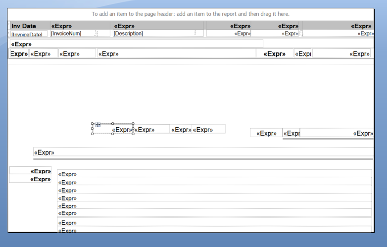

Trying to modify the APCheck so that it works for our check format. The current format of the SSRS APCheck have the detail (invoice detail) at the top and then the footer with the check info such as amount, payee, etc.
Our check format have the check in the middle with the stubs at the top and bottom. I can format it to print the detail at the top and then the footer to print where the check is. However, I need to print the detail at the bottom stub as well and this is where I am running into some issues.
Anyone have any thought how to also get the detail to print at the bottom since the footer is already being use to print the actual check? I cannot add a subreport to the footer.
I tried to use just the body of the report, but running into some challenges. For example, if I have multiple invoices in one check then this moves my check content down and doesn’t align correctly with the check.

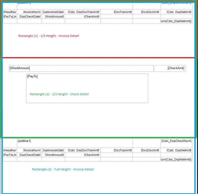

Use the body of the report only and (3) rectangles all positioned at 0,0.
First rectangle will hold the AP Invoice Table
Second will have the Check Detail
Third a copy of the AP Invoice Table
With the rectangles all anchored at the same location, the change in data in each does not affect the location of the others. Position the tables/fields in each rectangle so they are located where you want on your check stock.

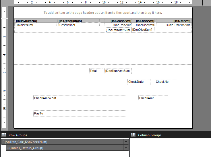

Thank you. That’s what I tried doing as well, but ran into an issue if I process multiple checks.
The first rectangle had the AP invoice table. The second rectangle have my check detail. I will add the third rectangle for the footer once I can get the middle section to print.
If I process 3 checks, the AP Invoice table printed correctly. However, my check detail will only print on the last page of the 3rd check.
Below is how I have my check setup. I also tried setting up 1 rectangle with multiple rectangle inside of that rectangle and have it set keep the print in one page, but it only print at the end of the last check as well. Am I missing something?
I missed the part where you said to have the rectangles all at position 0, 0. So after I did that, it only print on the first check. Any ideas how I can have that same rectangle repeat for each check number? This is when processing more than 1 check from the same group. If I process 3 checks, it will only print on the first check and the 2 last check doesn’t print the check detail.

I got it to work now. I added the AP Invoice table, add a rectangle to the detail row and then group it by check number. Inside of that rectangle, I added the AP Invoice Table again. Then I can add my 2nd rectangle for the check detail. Followed Brian’s suggestion about positioning the rectangle to 0,0. This seems to get what I need.

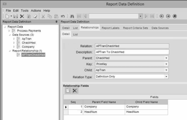

Just in case, here is my RDD. I did not modify it though as can get all required fields from a default set up.

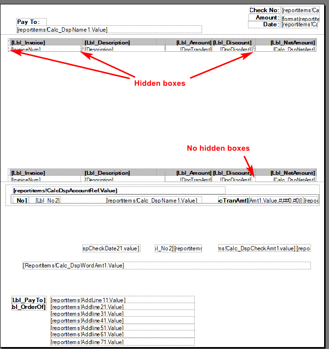

This may be helpful to you, and may not. We needed the invoice list details to show in the top two sections, and the check to print at the bottom. SSRS treatment of header/body/footer really makes this a mess, and the standard check format deals with it by using a bunch of very small hidden text boxes and then referencing their values with =reportitems!.. That’s how you get around the aggregate requirements, just reference the value of another textbox that is actually in the group. The other key to getting the second invoice list without causing a bunch of other problems is to remove all those hidden text boxes in the second list Tablix.
Here’s a freebie:
ChkPrint2.rdl (126.8 KB)
I just started using that format this morning, so no warranties.
In my experience in modifying the SSRS check, it is a real pita so do not try to add/delete anything. Hide and/or make the un-needed things, but don’t delete them.
For me personally, I found working with the RDL in a XML text editor to be the gamesaver rather than trying to use the report designer. At least in the XML will show you the parent relationship (rectangles inside of rectangles) and you can manipulate the report objects more easily this way.
Also, don’t mess with the RDD itself. All the data is there, you may just need to modify the query (again inside the RDL XML).
To get the desired result for a multi-format check, I recommend the use of rectangles for keeping things together and sub-reports (you can pass the tableguid and checknum fields). And I can’t stress enough that modifying the XML directly in lieu of the report designer will save you lots of headaches.

Once you have the Invoice detail table set up the way you want in the top rectangle, simply copy and paste the detail table into the bottom rectangle and position as desired.
