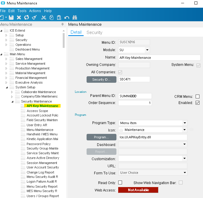

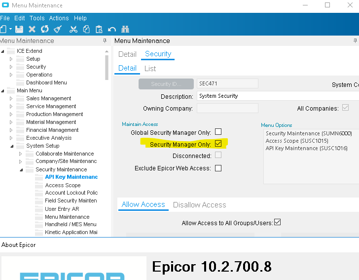

Looks like you need to be a security manager. Are you (your epicor user)?
Not sure if you can delete it, but if it was done by mistake, look at the details below to re-add it:

Thanks you for that solution, Carlos.
Looks like the “API Key Maintenance” module never installed by default. Not sure why.
I followed your instructions to add it into the menu under “Security Maintenance” and it is now accessible:
