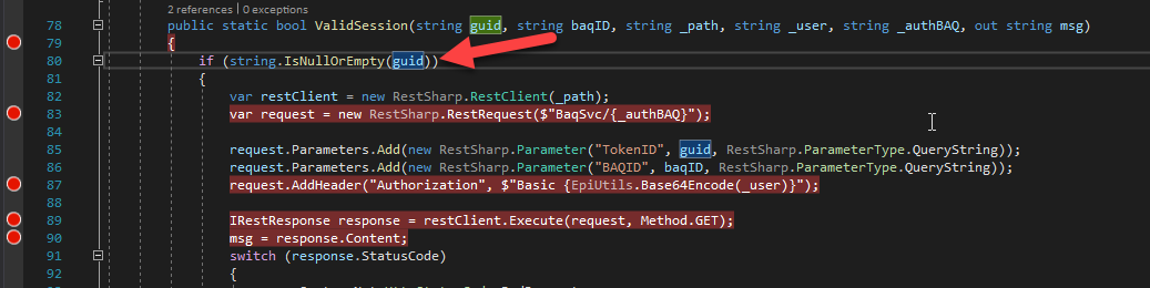

I’m passing in a valid Token but it keeps falling through:
Here’s the ValidSession method:
Here’s the Token being passed in (we know it’s not null or empty, right??)
From there, it then jumps out of that if statement and right to the unauthorized BAQ msg
Have I lost my mind or what??
EDIT: Should that be !string.IsNullOrEmpty(guid)
instead?
EDIT 2: Ok got it to work with changing that following code like I said.

Yup you got it
Sorry quick edit on the git removing some business specific checks I missed the ! on the last part of that good catch
I fixed it in the repo too
