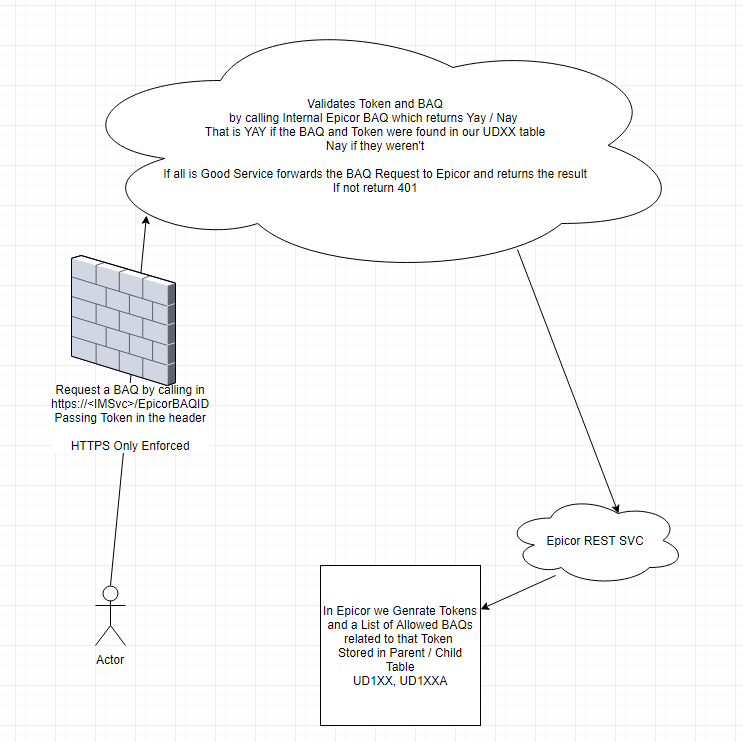

We do this we created an intermediate service with a WhiteListed list of BAQ’s that can be called and gave them private token they must send in with their request which we validate against a UD table.
Does that mean you also wrote the intermediate service or was there some other tool utilized to manage that?
I wrote the intermediate service
using .net core web api pretty straight forward nothing fancy just a way to shield the rest of the Epicor API and restrict access.
Maintenance can be an issue but we wrote it with this in mind so we can dynamically change which BAQ’s are allowed and generate “new tokens” which allow certain BAQ’s to run.
Basically this
and of-course we can delete / revoke the token at any time.
