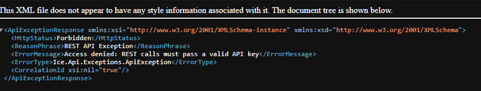

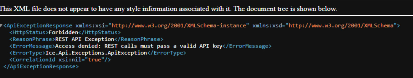

Okay I set up the BAQ and he is getting this error:
well then tell him to pass a valid API key…
The BAQ must be shared then it’ll show up.
Caveat is if you have set an access scope to the API Key. Then you’ll need to add the BAQ --and other Business Objects you want them to have access too-- in Access Scope Maintenance.
And all V2 REST calls require an API-KEY regardless of the service.
Yes but you don’t have to assign an access scope to them if you want them wide open.
Right. The error message indicated a missing API-KEY. They won’t even get to access scope checking if they don’t supply it first. And then yes, if a scope is defined (good for integrations IMHO) then it is checked.

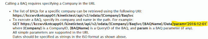

With the BAQ, you define a parameter and do the selection there. You then just pass the parameter value in on a URL request as shown above in Tammy’s Post:
