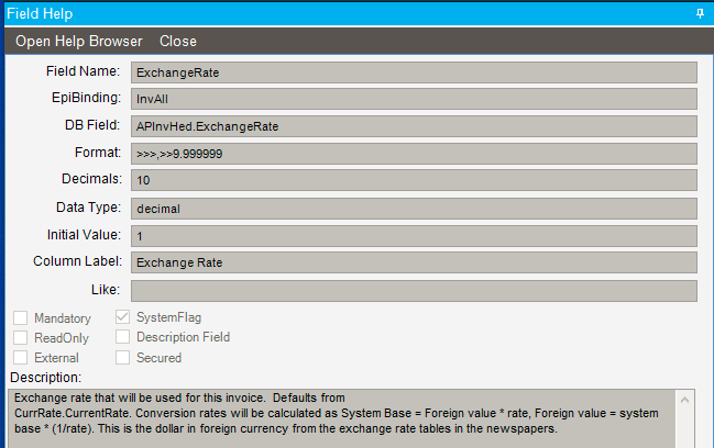

How does Supplier Tracker -> Links -> Invoices -> All -> Exchange Rate field work? the numbers are the same across all the invoices?
I read Field Help and still have no clue why it does not function properly.

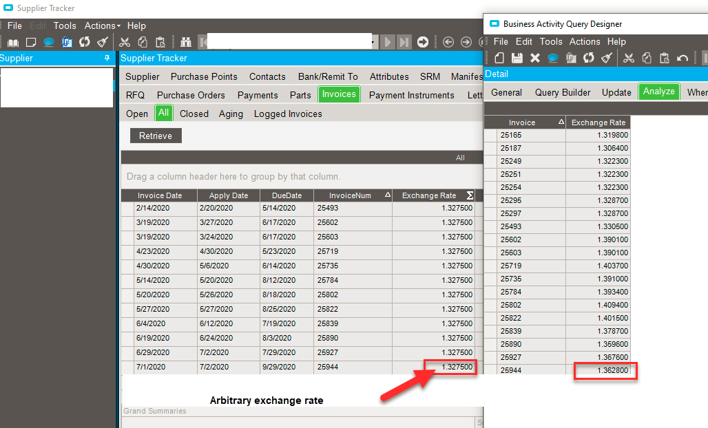

Can you verify the value is actually the same on the Database either using SQL or a BAQ? If the ExchangeRate on the database is somehow different maybe it could point to a bug in Supplier Tracker.
Hi Jonathan,
I use BAQ to pull ExchangeRate from APInveHed table, its value is the same as in invoice tracker, each invoice has its own exchange rate, and this is the expectation.
However, when I’m in Supplier Tracker, an arbitrary number is displayed for all invoices, I don’t know how this number is calculated.
Yeah this is a bug, it will show the same exchange rate found for the first invoice for all others.
I don’t see a workaround besides doing a BAQ or loading the invoice in Invoice Tracker.
Let me see if this is already reported and if not I’ll report it.

I think the reason they are pointing to a customization is that the column ExchangeRate is hidden.
I have created Jira Ticket ERPS-142409, however considering it is technically a cosmetic issue I can’t really tell you when it could be fixed based on priority.
If you want to see the ExchangeRate as it is on the database I would create a BAQ, the difference between the tracker and the BAQ is that the tracker will use business logic to calculate some External/Calculated fields while the BAQ only retrieves what is on the DB.
