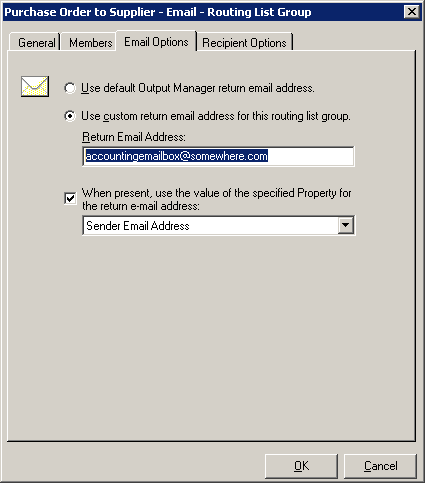

Under Routing Lists - Open the Routing List Name - Routing List Groups - Edit… - Email Options
There is an option to Use Custom Return Email Address for this Routing List Group:
Could that possibly be what you are looking for?
That just might be!
Lemme try it out and get back to you.
Excitedly awaiting the results…
Worked perfectly.
Thanks!
