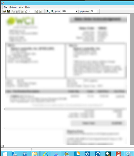

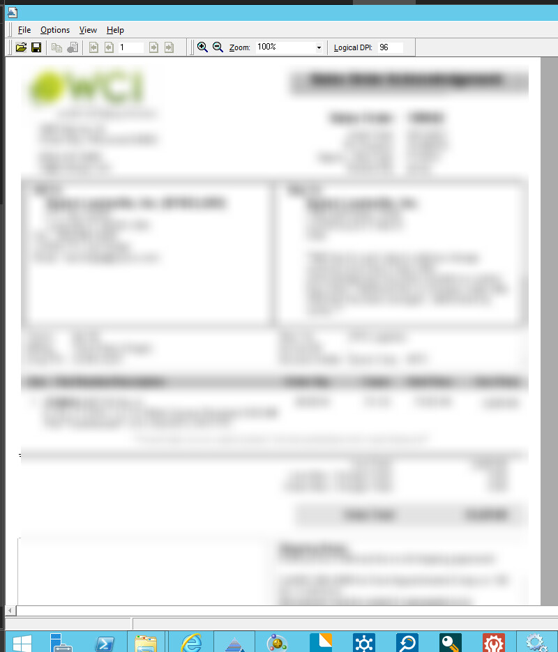

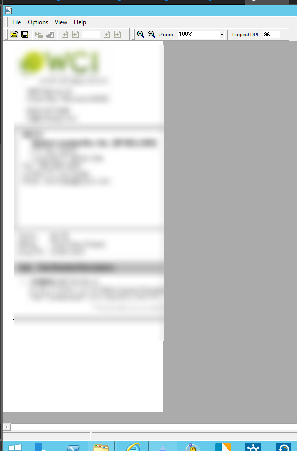

When Auto-Printed the actual “Page” looks like this (blurred to protect customer data)
But when previewed first it processes the full page and APM handles the page properly.

So we installed a small label printer the other day that installs a few User-Defined form sizes. It does not set them as defaults on anything. They in no-way get associated with the APM printer. However I deleted the forms that it installed any did a print and everything worked. The form doesn’t even have some kind of overlapping name. It’s called “My Custom Paper - 100-210mm”. This printer was not setup to be deployed to anyone. It was not installed on any of the end users computers. This form was not called anywhere. However somehow… Magically… It was being used.
