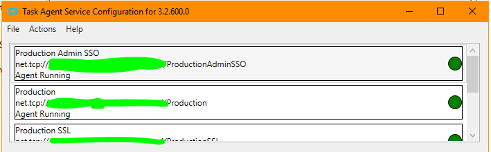

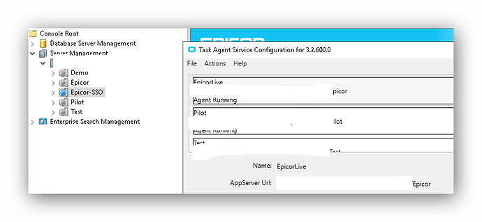

Is it possible your Task Agent is set to use that app server you didn’t restart? We have an SSO app server and a standard login app server for our production environment, and the task agent uses the standard app server. Whenever we make UD field changes we recycle both to make sure the task agent processes are updated as well.
Although now that I say that, I realize we’ve never tried to only recycle one app server. So it’s possible we’ve gotten lucky that we only have the two production app servers and that our standard process is to recycle both anyway.
I don’t follow. I have one for each, if that’s what you mean.
So you are saying that people can connect to different task agents than the environment that they are connected to?
That would explain it, sort of, and yet, umm… why? What directs someone to a different task agent?
I know there are specific ways to make sure specific agents pick specific tasks but I don’t usually do that.
If all 3 agents see the same scheduled task, it’s going to be picked up at random and if the data model in that server is not up to date you will get this error.
I could be wrong since I don’t work on this but this is how I understand it.
The reason they are interconnected is because the Entity Framework schema is a .dll that gets compiled / refreshed usually when you do a Database Regen and then you need to Recycle each App Server to update its EF .dll in memory.
