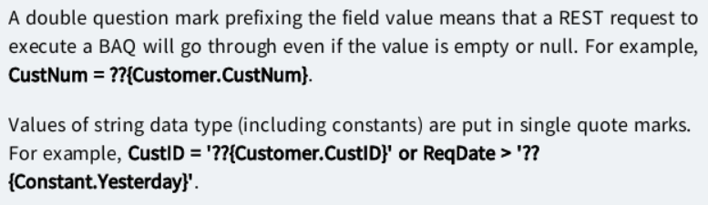

I see the ? and ?? thrown around on some of the EpiUsers #experts-corner posts, as well as when inspecting native Kinetic layers. What exactly do they represent? I’ve seen some mentions of “can be null”, but not much more.
