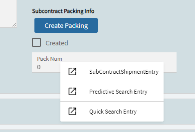

yes i added new customization. i am trying to add new function when click on create Packing button auto generate packnum but it doesn’t work.If you have any idea how to do it can you please guide me ?
When i select type-Subcontract that time i want to create packslip from po entry screen which redirect to subcontractShipmentEntry screen.

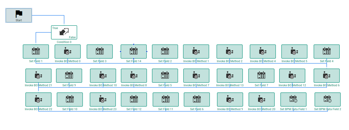

I already created bpm for that but i don’t know how to trigger in app studio,specially when i click on button (Create Packing) that time get new packnum in column. and redirect from po entry screen to subcontractShipment entry screen and set some field.

hey i set method directive now how to link in app studio ?
how i can use method directive in trigger event ? is there any way that i can call the method directive?
