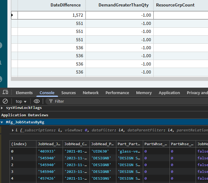

My DataView:
Plenty of data:

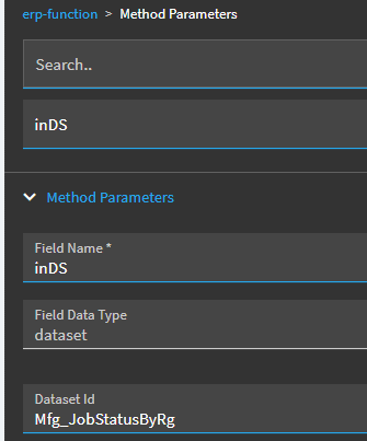

My Function parameter:

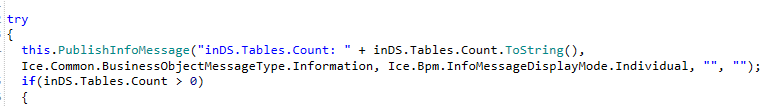

Beginning of my Function (it never even gets in the if statement):
Return message from my Function:
My Method Parameter:
