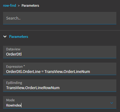

Example, I needed to find a specific row in OrderDtl given a previously saved OrderLine number and then make that the current row using row-current-set
Note: row-find has 3 modes, RowIndex, Exists, or Count
this example uses RowIndex
Note: RowIndex is a zero based index of the existing rows (i.e Not the OrderLine number), which is what row-current-set needs in the next step
Here is how the row-find is setup:
TransView.OrderLineNum is set earlier in the event using row-update to save the current line.
I tried lots of variations on the expression syntax, what I hadn’t tried though was using a single ‘=’ sign…to me this is very odd…expressions typically use “==” or “===” and "=’ is typically reserved for assignment…(I thought)
The EpBinding TransView.OrderLineRowNum is the RowIndex for the line I am looking for in the OrderDtl view (or -1 if not found).

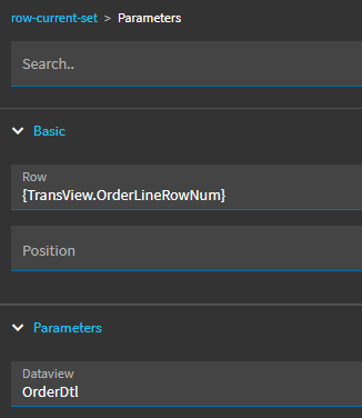

This is how the row-current-set is setup:
Quite simple once it works…
