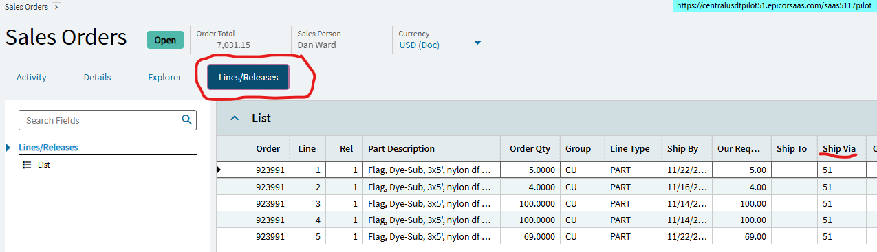

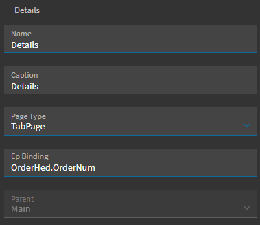

I posted earlier this week regarding making a new tabpage in Order Entry Details, which is now working fine…mostly
I have several fields/columns that would be better as combobox’s, for example ShipVia (OrderRel.ShipViaCode), I would like a combo so the user can select using the description, not the code.

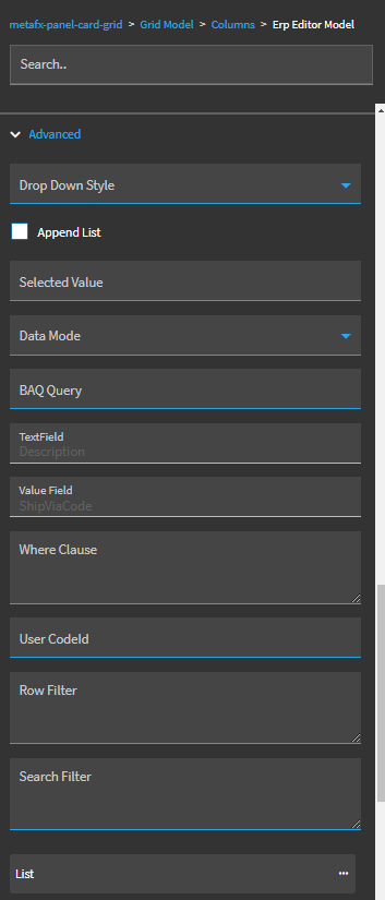

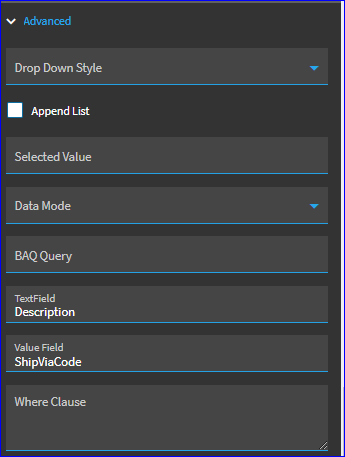

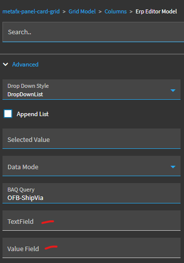

  • created a ShipVia BAQ to return the Code and Description and specified the BAQ in Grid Model / Columns / Erp Editor Model / Advanced, but the Text Field and Value Fields are not editable

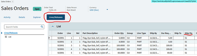

I looked at Order Entry, Lines List and Releases List grids and there appear to be no fields that use Combos in those grids (e.g. the Releases grid does not use a combo the ShipVia like it does in release details.

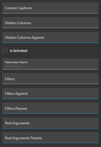

here is the case where I can edit some of the fields in the “Advanced” section, but typically you would specify the TextField and ValueField which are both not editable

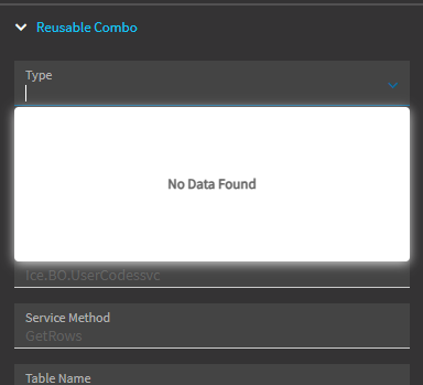

Are you getting something like this in the Type dropdown?
I had to just type in the name of the combo class and it disappeared, but still functions as expected
I was able to set the Type and Sub Type, but then other fields like ComboId, Service, and Service Method are not editable.

But Order Details is a tabpage
Yes, I guess that’s a valid point, only difference mine being a new/custom tabpage as opposed to a tabpage built/provided by epicor…

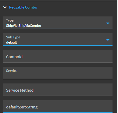

Create a combobox off to the side and set it up with the ShipVia.ShipViaCombo / default settings… take screen captures of all the settings you need.
Now, in your grid column Editor Model > reusable combo…
Enter Type: ShipVia.ShipViaCombo
Sub Type: LEAVE THIS BLANK!!
Manually fill out all the other properties you need.

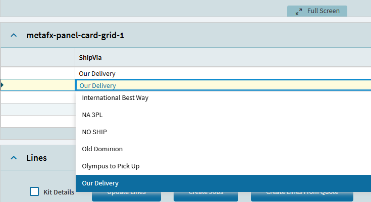

I set this up but I’m not pinging against an updateable BAQ so I can’t test it as a dropdown… but my test display grid IS coming back with the description and not the code.

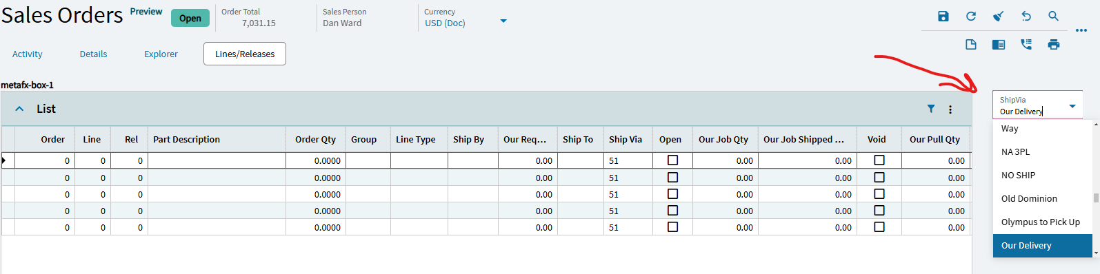

Okay, here is what I did (following @dcamlin)

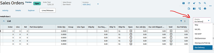

put a ship via combo on the side of my grid on my new tab page:
went to grid-model / columns / editor model and TRIED to setup combo the same way, I can fill out Reusable Combo / Type to “OrderRel.ShipViaCode” but lots of other fields are not editable (ComboId, Service, Table Name, etc)…same in the Advanced section of the editor model

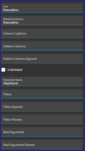

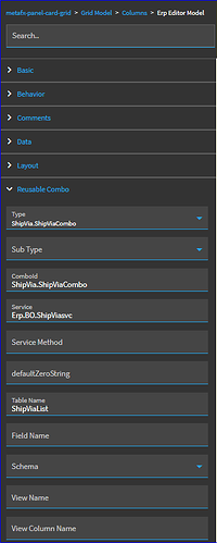

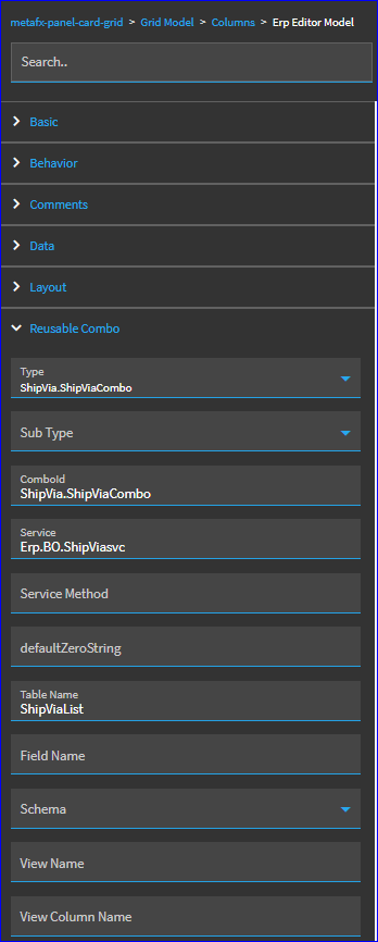

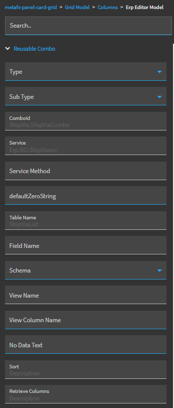

Below is my Reusable Combo… inside of the Grid Model > Columns > Erp Editor Model:
I just typed in the same settings from the “default”… without choosing “default” as the subtype.
Sorry, that was a copy paste error “OrderRel.ShipViaCode” should have been “ShipVia.ShipViaCombo”
Yes, I have the exact same properties (for the grid on the Order Details page)
Here are the screenshots:
It works for my grid on Order Details, but on my new TabPage with same grid, tied to same data source/baq, and tied to same view, most/alot/all of those properties I need to fill in are not editable :face_with_thermometer:
anything happen if you type in default for the subtype… and then delete it?
Mine will actually toggle readonly and then back to editable.
