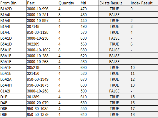

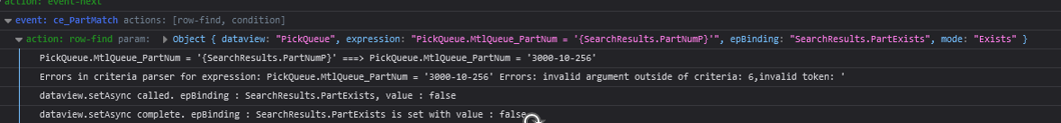

Some records it finds. For records it does not find, the developer tools show “invalid argument outside of criteria.”
When using the debug tool, all of the expected records show up in the PickQueue data view, including the records that the row-find widget could not find.
I tried both an “exists” and an “index” row-find. For the records it found, the index was correct based on what was showing in the PickQueue data.

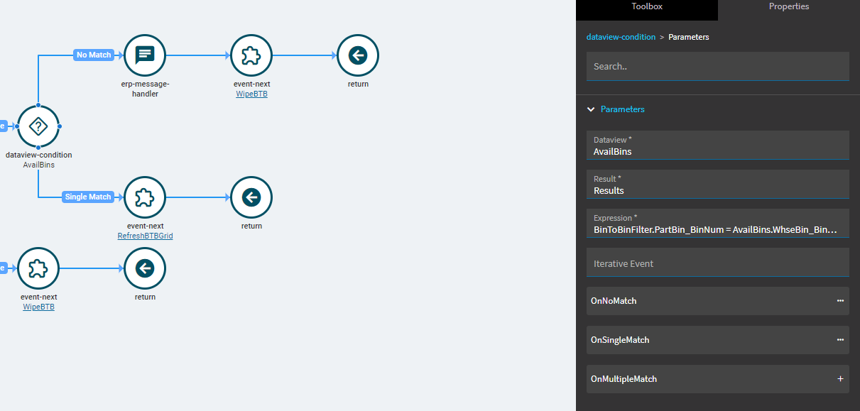

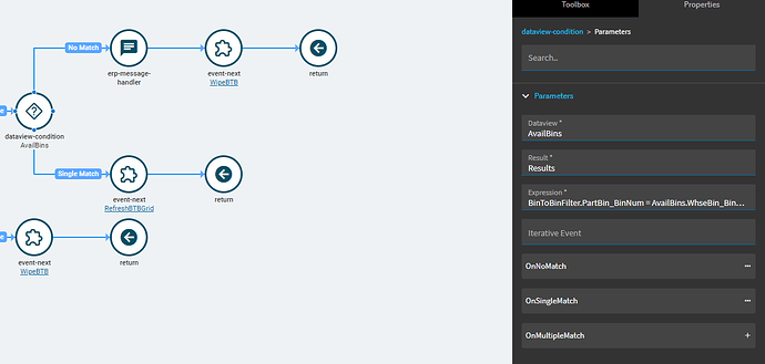

I have tried to Use the Row-exists before and i struggled on using it. But i did get something to work, and i have used it in place of row-exists in all places i needed validation.
I used dataview-condition set the “Dataview” parameter to a BAQ filled Data view and left the Iterative event blank. The behavior that this produces is similar to the behavior you are trying to produce.
It checks the Expression against every Row in the “Dataview” Parameter, all rows that equate to true are added to the Results parameter(this can sometimes be left blank, don’t know why sometimes it can be blank and others not.), But it doesn’t run the Iterative even on each row success because its blank.
Then you use the on match/on single match/on multiple to determine the pathways you want to go down. so i’m my case if the entered bin ( a bound textbox) was a bin that existed in “AvailBins” then the “on single match” would trigger, if the entered bin wasn’t on the List it would do “no match”, and if there was “multiple matches” it would do nothing because i didn’t capture that case.
