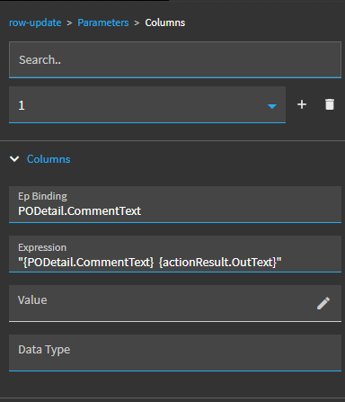

I have tried placing the row update before and after the property set, but neither work. The property set, shows the data perfectly with line breaks, but as soon as I process the row-update, the data reverts back to not having any line breaks, not even the original one in the text.

EDIT: neither, use Value prop rather than Expression on row-update
I am not sure how to find out. Here is what I can show. For property-set, The Prop is value and the Value is “{PODetail.CommentText} {actionResult.OutText}”
For row-update,
What can I do to answer your question?
Oh I can see \r\n in the OutText in my dev tools from my AddFile function response.
Ohh I got it! I have property set first, then row update. I moved the expression to the value instead and it seems to be working!

makes sense I think. silly me told you in your other thread to try Expression cuz json validator on Value doesn’t like the #_ tokens but turns out they’re not needed. maybe.
I wonder if that’s the fix and you don’t need property-set(?)
YES! Property set not needed! I just removed it and left the rowupdate in there. Still working correctly! Thank you!
Right cuz new value bubbles up from data view via epbinding. We all learned something on this one. Thanks!
