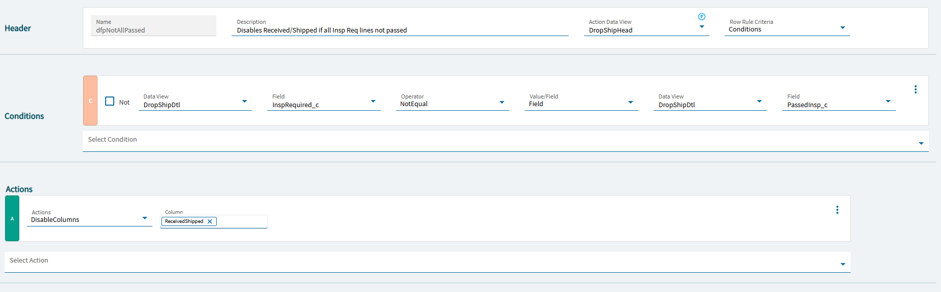

I’ve got a data rule for Drop Shipment Entry to set the DropShipHead.ReceivedShipped disabled based on the condition of two columns in the DropShipDtl dataview that I need it to evaluate all rows at once.
Currently it works according to whichever Drop Ship Line row I’m clicked on on the header, but I need it to work row-selected agnostic.
Any ideas?
Here’s my data rule:

I have no doubt I can use an event to find the rows I want, then set the field I want to disabled/read only.
The struggle with that is then what triggers that? It’s not going to be just one thing. I need it to “just be” (i.e. how a data rule works) not fire off some behaviors, if that makes any sense.
I don’t think a data rule is going to work.
