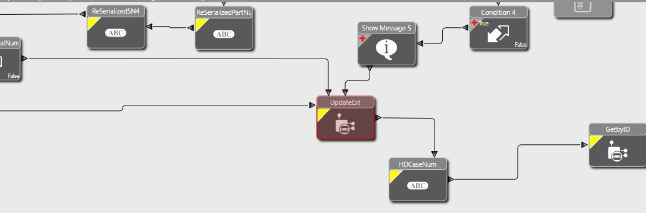

hi @klincecum thanks for the reply. I am trying to update a field via bpm -post processing and I want to refresh the case entry Maintenance screen after the bpm. for that i used get by id method in bpm. it is refreshing however i am encountering the Application error.
I have a feeling I know what you did. Show your BPM.
please take a look.

Anyway, you did a GetByID, but then you did nothing with it.
You’ll need to modify the data coming back from the call with the data for it to show on the screen.

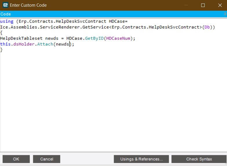

You’ll need to dona GetByID and store it in a variable called newds then use
this.dsHolder.Attach(newds)
This will replace the returning data with the newly acquired get by I’d response and will “refresh” the screen
Hi @josecgomez Thanks for your Inputs , i tried the approach recommended by you.
see the below code for the reference.

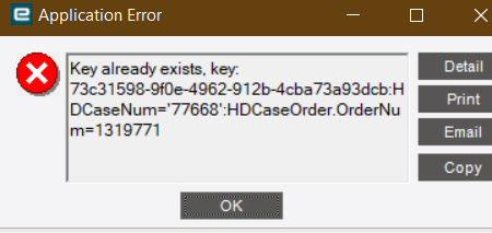

I am still getting the same Error , what am i missing. surprisingly i don’t have any issue in any other screens for refreshing ui via bpm . the only caveat is here the case entry screen.
Error:
