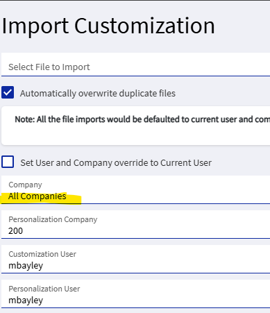

Did you set all companies when you imported the layer? The default is to import to your current company.

Yes all companies was set. But since the layer existed previously it failed on the upload since layer was linked to the company specific.

Delete all layers with that name first before trying to import the layer for all companies
Appreciated, this was my last resort which i did pre test prior to posting this. wanted to make sure theres nothing else i am missing. Thanks for the help
