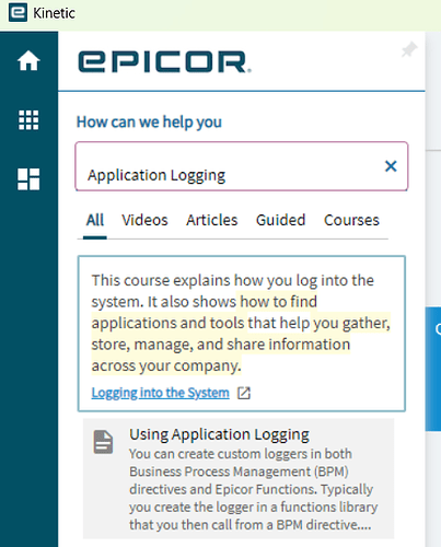

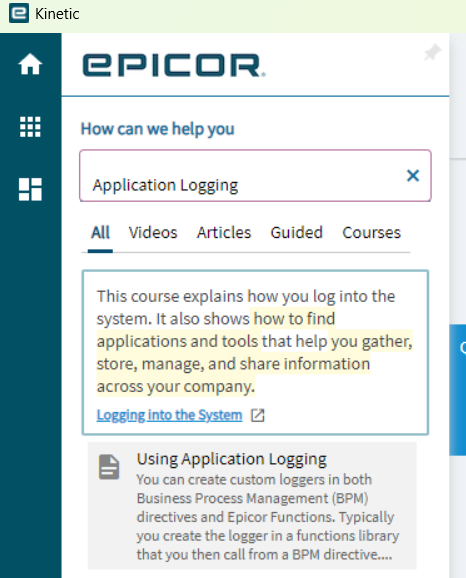

From the help →
You can create custom loggers in both Business Process Management (BPM) directives and Epicor Functions. Typically you create the logger in a functions library that you then call from a BPM directive. The logger generates the application logs. Application logging captures errors and tracks specific Kinetic activity. You define what an application log captures and tracks by creating a custom logger. You can then better locate the causes of issues or capture process calls.
You can find the help from the client by searching like so:

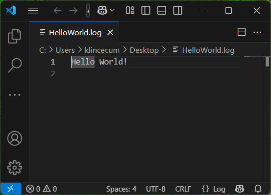

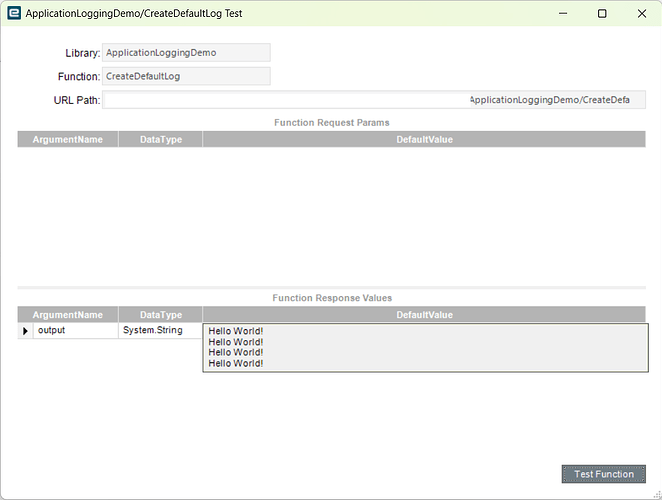

Creating Default Logs
Code Example
//refs:
//Microsoft.Extensions.Logging.Abstractions.dll
//Microsoft.Extensions.Logging.dll
//using Microsoft.Extensions.Logging;
//using Ice.Logging;
/* Example uses C# 8, so this is wrong for us.
using logger = Ice.Logging.ApplicationLoggerBuilder.CreateDefaultBuilder(this.Session, "LogId")
    .Build();
logger.LogInformation("Log message");
//This is based on the session, so this will write a file called "HelloWorld.log" to the 'EpicorData/Users/UserName/Log/' folder.
//In my case -> 'EpicorData/Users/KLINCECUM/Log/HelloWorld.log'
//In the default logger, this will add '.log' to the name.
string fileName = "HelloWorld";
using (var logger = Ice.Logging.ApplicationLoggerBuilder.CreateDefaultBuilder(this.Session, fileName).Build())
    logger.LogInformation("Hello World!");

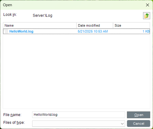

//Pudding ->
var file = new FilePath(ServerFolder.UserData, $"Log/{fileName}.log");
output = Sandbox.IO.File.ReadAllText(file, System.Text.Encoding.UTF8);
Function Tester
Server File Download
Log File

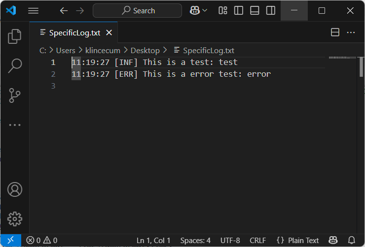

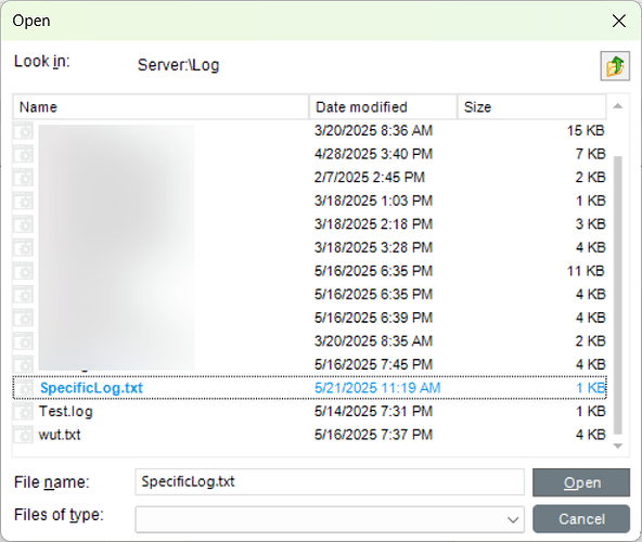

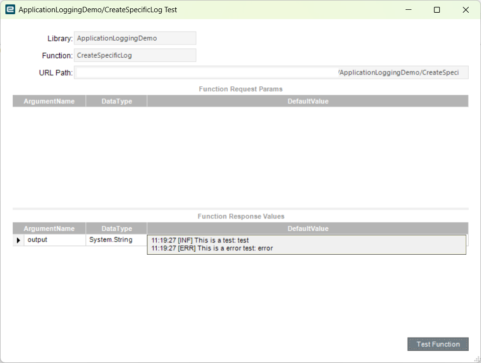

Creating Specific Logs
Code
//refs:
//This is based on the session, so this will write a file called "SpecificLog.txt" to the 'epicordata/Companies/YOURCOMPANY/Log' folder. (path is not exact)
//In my case -> 'epicordata/SITEID/Companies/YOURCOMPANY/Log/SpecificLog.txt'
//We can use an arbitrary name and extension here.
string fileName = "SpecificLog.txt";
var logger = ApplicationLoggerBuilder.CreateBuilder()
    .SetMinimumLevel(LogLevel.Information)
    .AddFile(
        options =>
            options.Session = this.Session;
            options.FileName = fileName;
            options.Folder = LogFolder.Company;
            options.MessageOptions.QuoteValues = false;
            options.MessageOptions.ShowLogLevel = true;
            options.MessageOptions.TimestampFormat = TimestampFormat.Time;
    .Build();
using (logger)
    logger.LogInformation("This is a test: {Value}", "test");
    logger.LogError("This is a error test: {Value}", "error");
//Pudding ->
var file = new FilePath(ServerFolder.CompanyData, $"Log/{fileName}");
Function Tester
Log File

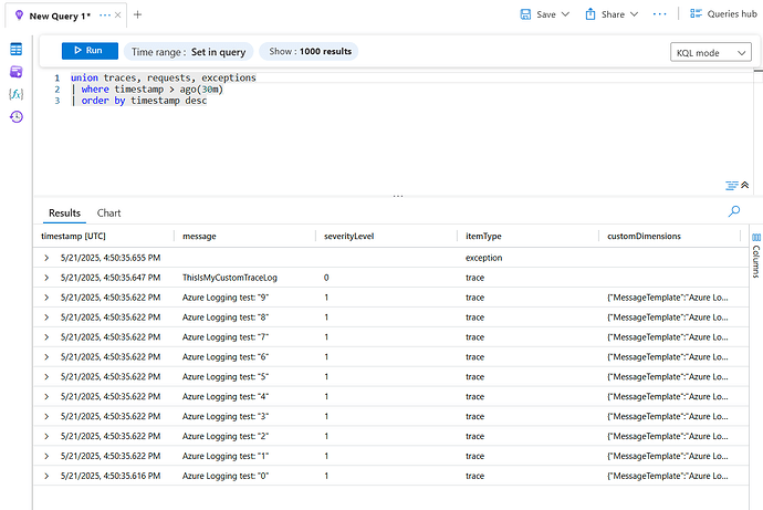

Create an Application Insights Log
Yes, you can log to Azure, right from inside Epicor.
I’ll come back and add some instructions for setting that up in Azure.
Code
//refs:
//Microsoft.ApplicationInsights.dll <- For Going Further
//Going Further...
//using Microsoft.ApplicationInsights;
//using Microsoft.ApplicationInsights.Extensibility;
From the example ->
const string connectionString = "InstrumentationKey=aaaaaaaa-aaaa-aaaa-aaaa-aaaaaaaaaaaa;IngestionEndpoint=https://centralus-0.in.applicationinsights.azure.com/;LiveEndpoint=https://centralus.livediagnostics.monitor.azure.com/";
using var logger = ApplicationLoggerBuilder.CreateBuilder()
    .AddApplicationInsights(
        options =>
            options.ConnectionString = connectionString;
    .Build();
  //See this beauty... Yep, we can log straight to Azure.
  string connectionString = "Put your own key here, looks similar to below.";
//string connectionString = "InstrumentationKey=aaaaaaaa-aaaa-aaaa-aaaa-aaaaaaaaaaaa;IngestionEndpoint=https://centralus-0.in.applicationinsights.azure.com/;LiveEndpoint=https://centralus.livediagnostics.monitor.azure.com/";
          options =>
      .Build();
  using (logger)
      for(int x = 0; x < 10; x++ )
          logger.LogInformation("Azure Logging test: {Value}", x.ToString());
  //Or you can go further down the rabbit hole...
  using (var config = TelemetryConfiguration.CreateDefault())
      config.ConnectionString = connectionString;
      var telemetryClient = new TelemetryClient(config);

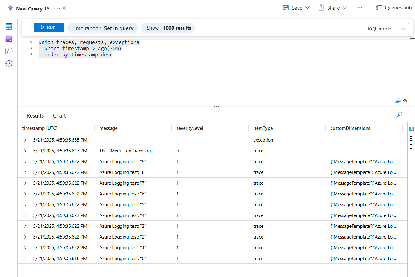

      telemetryClient.TrackEvent("ThisIsMyCustomEvent");
      telemetryClient.TrackTrace("ThisIsMyCustomTraceLog");

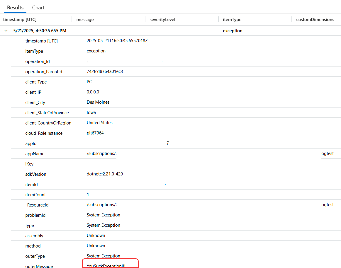

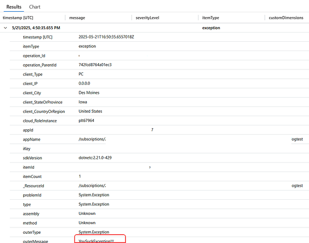

      telemetryClient.TrackException(new Exception("YouSuckException!!!"));
Kusto Query
Exception expanded

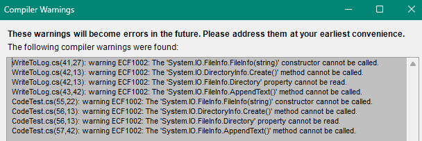

Where did Sandbox.IO come from? Is that only in cloud or newer than 2024.2?
I get warnings about writing directly to a file using System.IO stuff - I guess there has been other chatter about Epicor removing these at some point (although I can ignore the warnings it does currently work on 2024.2.10):
I saw your code and thought maybe there is a correct way to write to a log file and avoid these warnings, but I tried the ApplicationLogger stuff and wasn’t happy that I couldn’t get it to write to:
