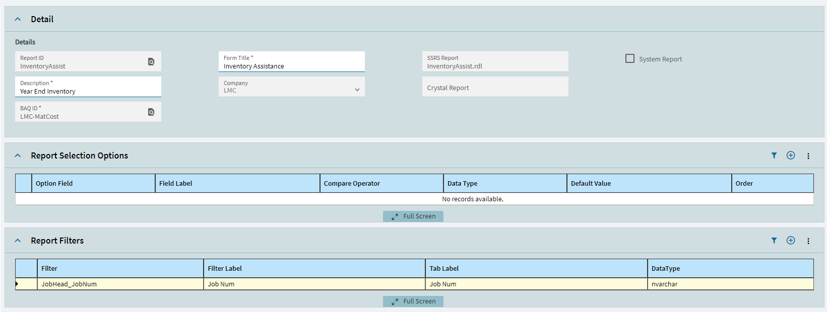

I made an application in BAQ Report Designer and added a filter for JobNum. When I preview the application and try just typing in a job number in the filter and then hitting enter, a job number does not pop up, the text just goes red.
The only way to get multiple jobs in the report is to click on the magnifying glass icon and then manually check off each job number.
Did I do something wrong when creating this application? What can I do to fix this?
You should use Report Selection Option and set compare operator to be “LIST”. Give it a shot and check?
Nope, that did not seem to work. I am able to add only one job to that text box and it shows on the report.
