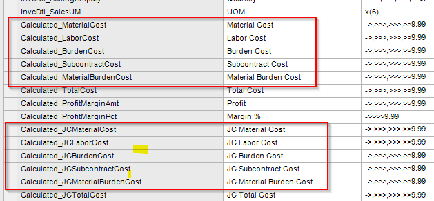

I think on SGM John is correct, been a while. That’s why many struggle to show the SGM on the AR Edit List, before posting, because it the MaterialCost, LaborCost, Burden get calculated at COS/WIP that is for Standard Costs…
I think Josh is thinking of the JC Job Costs, those get populated upon Job Closing (btw if you close a Job and then Invoice the JC Costs dont get populated, known Epicor bug), even if the Invoice is Posted and COS/WIP is complete. I think John is saying you run the risk if someone were to add more stuff to the Job or change Costs after invoicing, posting. So your trustworthy number is after the Job Closes, but if you know no one is adding anything then you could trust the JC Columns.
After the COS/WIP is captured. Until that happens, nothing is guaranteed. I also believe this is when Part costs get updated that are not Standard (Not 100% sure though).

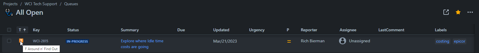

It doesn’t come without a cost. A lot of FAFO
It even has it’s own task category in Jira
