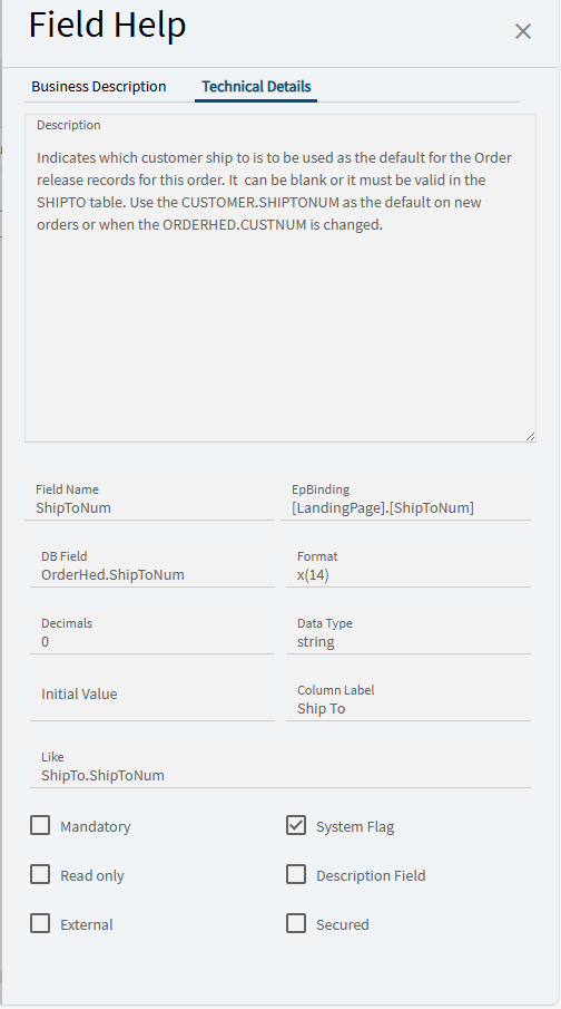

I was tasked with another ask from my organization to add the ShipToNum from the Order Entry screen to the AR Invoice Tracker. Figured I would give this a try myself, however I seem to be having issues with determining which method is used in the post processing directive. To my understanding it should be using the Erp.BO.ARInvoice.GetList for the BPM Method Code and then within C# trying to pull the ShipToNum from OrderHed but haven’t been successful. Thinking similar to the code for the PO Entry screen but slightly different logic. I tried to use a BPM to just hard set the value to some static text to see if I could verify it’s writing to the grid but it’s not showing within the grid. Any pointers to determine which method is used where outside of Developer Tools (F12)? I feel like this is very easy, but I am missing something.
