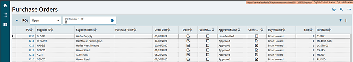

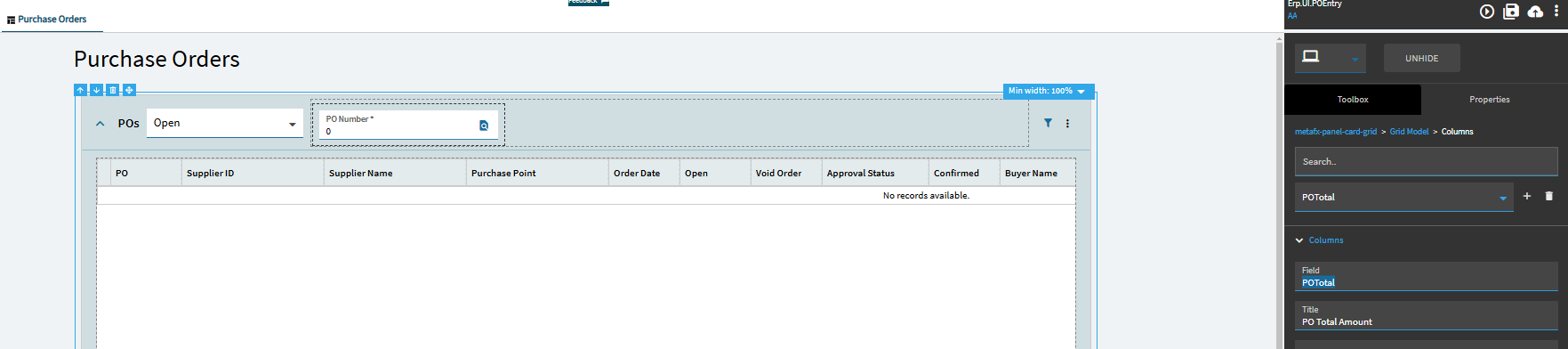

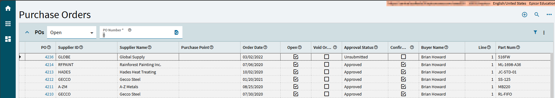

First time posting and very new to Kinetic. I have been researching information on this before I posted but am coming up short. I am trying to add the POHeader.DocTotalOrder Column to the Purchase Order Entry LandingPage.
I followed the Epicor Learning Center example here: Hands-On - My First Layer in Application Studio however I cannot get the data to populate in the grid.
The system dataview does not contain the column I am looking to add though it is associated to the same tables of that which the other data is being returned. What am I missing?

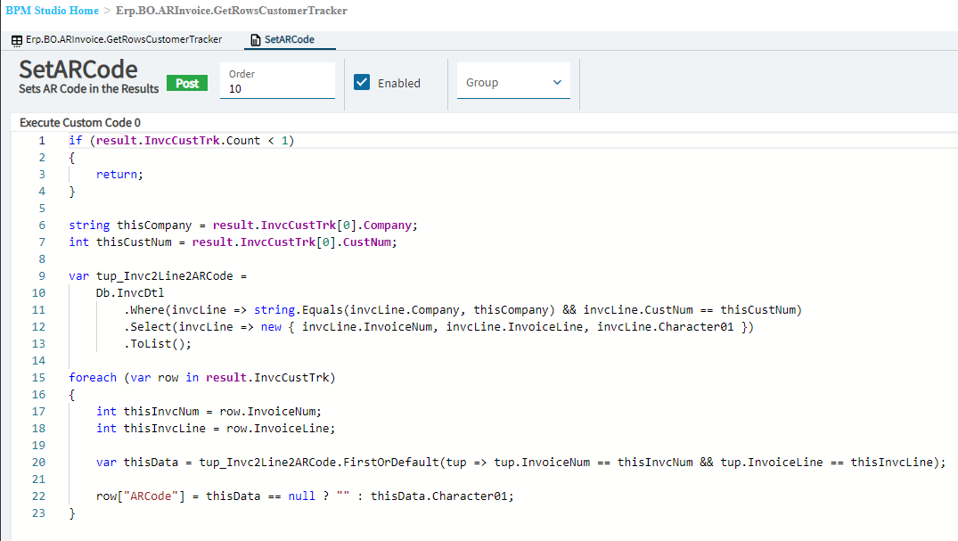

When getting just a few fields inside a BPM, I would use the Db context to pull it. Something like this in a custom code widget:
…and not directly related, but I’m just going to throw this in here for good measure, because it can save a lot of time banging your head against the wall:

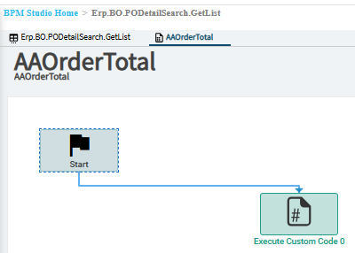

Add a Post proceesing BPM to method directive to Erp.BO.PODetailSearch.GetList using this code
foreach (var row in result.PoDetailSearchList )
    var PoheadData = Db.POHeader.Where( x=> x.Company==row.Company && x.PONum==row.PoNum).FirstOrDefault();
    if (PoheadData!= null)
        row["POTotal"]=PoheadData.DocTotalOrder;
next then add “POTotal” as new column to your grid
