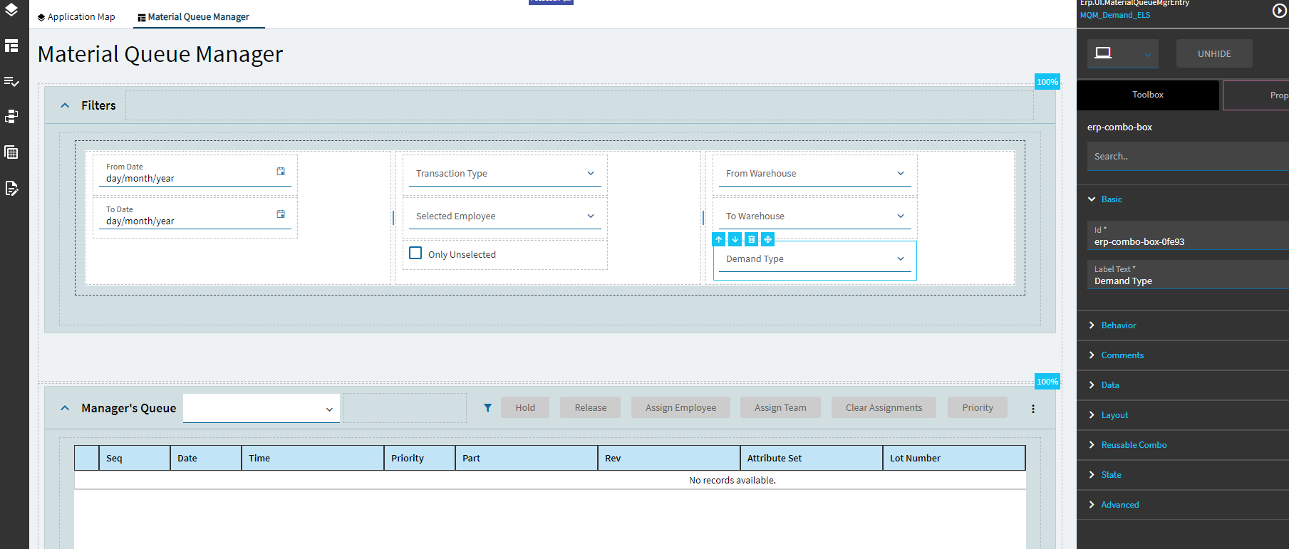

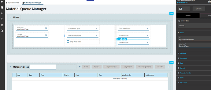

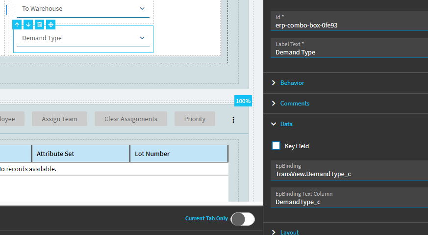

Hello, within application studio on Material Queue Manager I have added a new ‘Demand Type’ dropdown which I would like for it to look at a UD field on the material queue for the values, and filter the gridview.

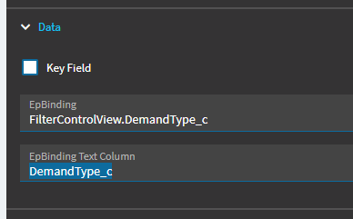

In the Data EpiBinding fields I am setting EpBinding to FilterControlView.DemandType_c
EpBinding Text Column
DemandType_c
How can I get it to list the values and filter the grid ?

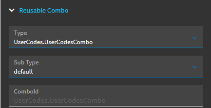

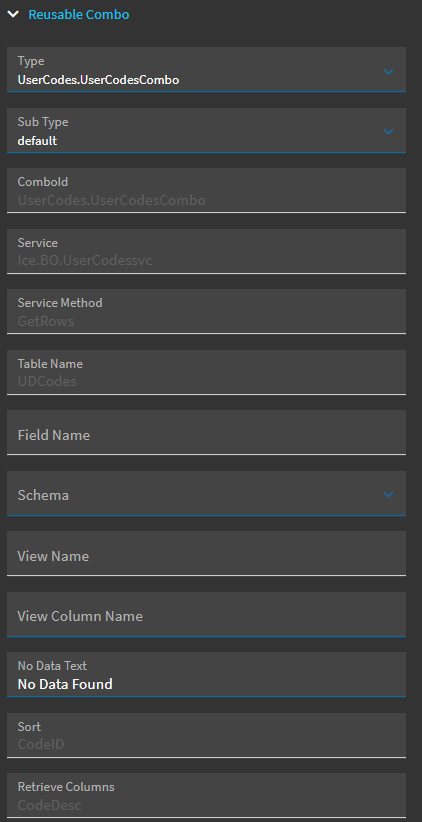

You then have to set up the Reusable Combo. There is a default in Epicor for UserCodes.UserCodesCombo
In the bottom section of this setup, you can add your Filter Params
In my case the UserCode (Code Type ID) I wanted to use was DWG_Source

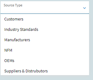

This results in my fist dropdown displaying like this:

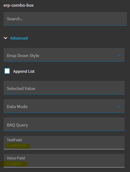

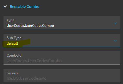

Note that it is actually displaying the CodeDesc of each UserCode… not the Code itself (C, I, M, N, O, S). This is the result of using the “default” subtype of your UserCodeCombo.
If you look in the Advanced area, you can see that it is looking at the Value Field of the CodeID… but it is returning the CodeDesc of that User Code.
If you want to show the CodeID itself (for example)… you’ll want to delete the “default” option at the top in the subtype field… and then you can rebuild the combobox setting manually. Most will be the same as the default. But then, here in Advanced, you can set both Value Field and TextField = CodeID.

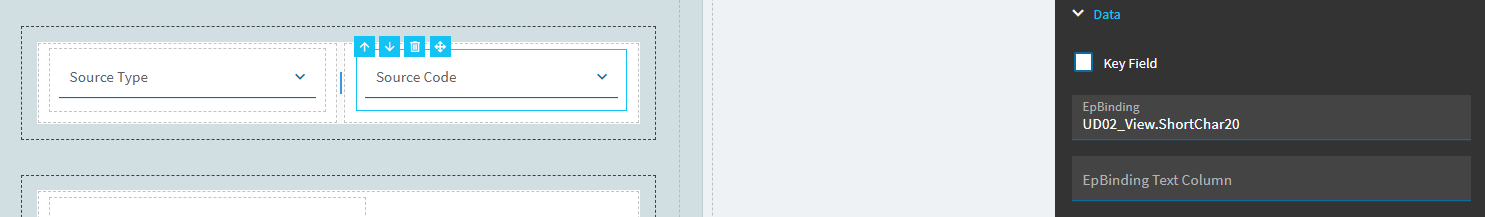

Combobox #2:

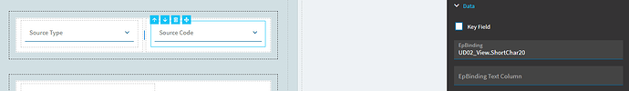

Set up largely the same way. I have this one bound to UD02_View.ShortChar20
In my case, I still chose the standard UserCodesCombo & default subtype
The only difference is the Filters Params. In this case, I want to filter this second combobox by whatever was selected in the first combobox. So my filter params is: CodeTypeParam=?[ShortChar19]
Make sense?
My ComboBox #1 is set up to query UserCodes, and is filtered by a distinct UserCode (DWG_Source). That selection was bound to ShortChar19.
My ComboBox #2 is set up to query UserCodes, but it is being filtered by whatever value is being held in ShortChar19.

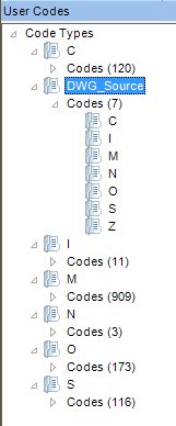

Here are my UserCodes:

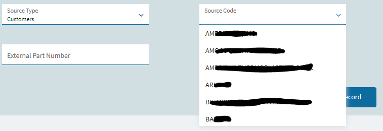

So, the DWG_Source was ComboBox #1. The user selects “C” (Customer… in our world that means this drawing was given to us by a customer).
ComboxBox #2 should now show a list of all customer UserCodes that I set up under CodeType “C”. Again, showing the CodeDesc (which in this case is the Customer’s Name… so, I need to redact, haha).

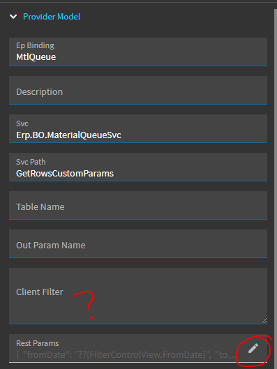

Then, click on your grid… navigate: Data > Grid Model > Provider Model

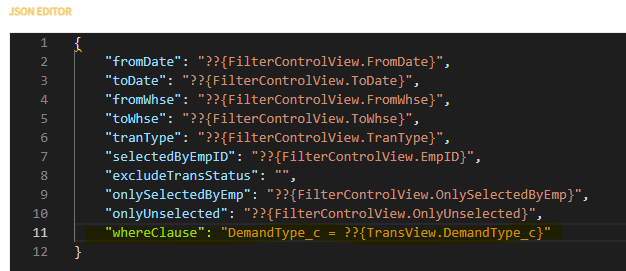

Epicor has an area for “Client Filter” which is supposed to allow us to filter the returned results… but I couldn’t get it to work.

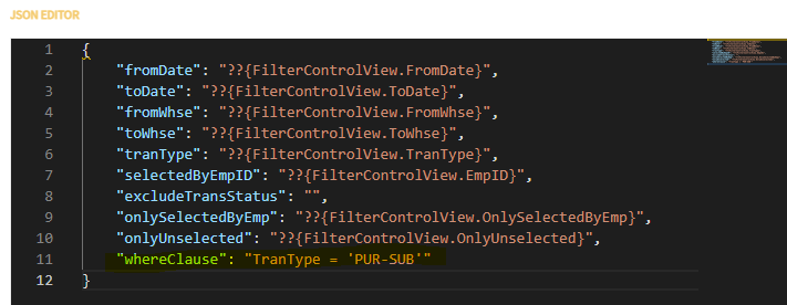

Instead… I did have some success in adding a Where Clause to the Rest Params… so let’s try that. Click on the edit/pencil.
I tested by adding a whereClause to filter by TranType… and it worked:

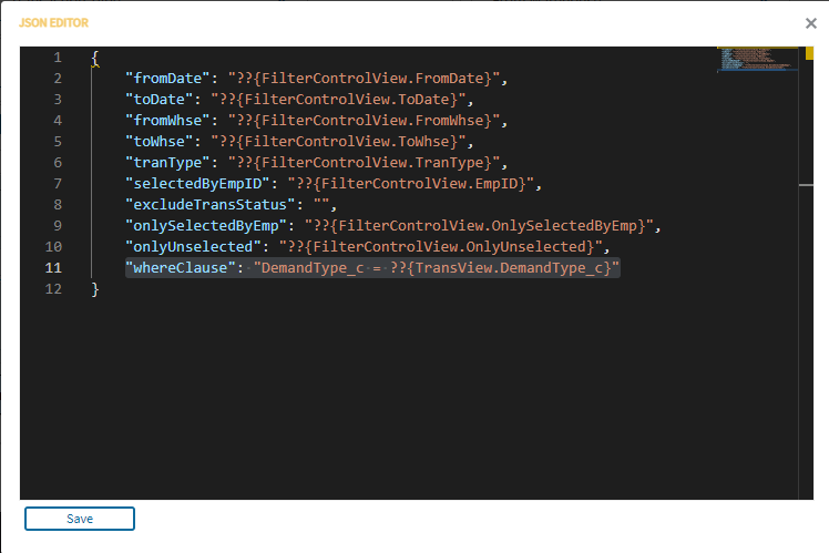

So… I would try the below whereClause and see if it works:
Hey, thank you so much for this, it’s very very helpful. I am getting an error on the grid but will explain where I am at.
  1. I have created the dropdown which pulls back the user codes successfully and also changed the EpiBinding to TransView.DemandType_c

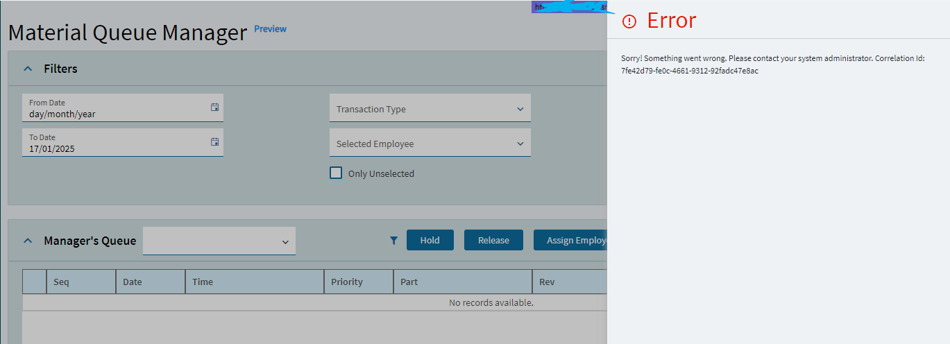

  1. On the grid I have gone into grid model > provider model and edited the rest params to include “whereClause”: “DemandType_c = ??{TransView.DemandType_c}”

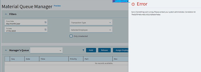

  1. When I preview I get sorry! something went wrong. Please contact your system administrator.
DemandType_c UD field is on the MtlQueue table but it is not included as a default field on the grid. I dont know if this matters.
Hi Emma,
Could you try wrapping it within single quotes, for example:
“whereClause”: “DemandType_c = ‘??{TransView.DemandType_c}’”

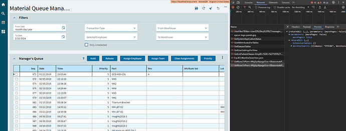

If that does not work then you might need to hit F12 to see what is going on within the console / network response which might provide a more meaningful error.
Just the job !
I also added the column DemandType_c into the TransView Data View to make it visible on the grid.
