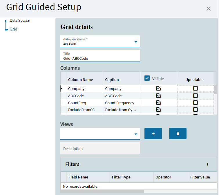

The short answer is, the Wizard you used is a little more “Ron” than it is “Hermione”.
This can be frustrating… you didn’t do anything wrong. Playing around with the wizards a couple weeks ago I saw two paths.
The Wizard at the start of App Studio “Path A” creates your first DataView, even gives you a dataview grid… but doesn’t create a “get” event to populate it.
Another method “Path B” - I’ll expand on a little more because you took “Path A”(read through because there’s another gotcha) … looks like this…
Instead of using the Wizard right off the bat… you manually create a dashboard. Choose Dashboard as the type, and then give it a name in the ID field.
Once created and loads, then click on the DataView icon and click NEW. You can use the DataView Wizard HERE (we’ll call this one “Harry”), instead.
Source Type: BAQ
Choose your BAQ… give it a name… Next

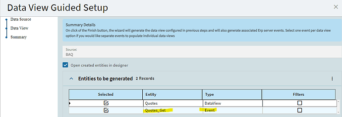

When you do it this way, you’ll notice the next screen looks like this:

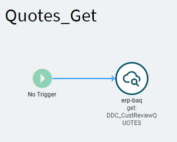

Not only is the Wizard creating the DataView, but also an event to populate the dataview.
HOWEVER… in THIS route (“Path B”), we manually created the Dashboard, but it didn’t give us the LandingPage Grid that “Path A” gave us. So, you have to manually add that to your form, set it up to your BAQ DataView, etc.
PLUS… the Get event is not set to a trigger. So you have to either give it a trigger, or create another event that fires when you want (after form onload, for example) and then tack this event on as an event-next.
So…
“Path A” (Ron) gives you your dataview and a grid, just not the event.
“Path B” (Harry) gives you a dataview and event, but not your grid.
Either way, you have to build out from there.
Since you already started down “Path A” you just need to create a new event mimicking the one above which performs the call that uses your baq to fetch data and fill in your BAQ DataView.
Maybe someday they’ll build this out and give us “Hermione”, but for now, you have to go with either “Ron” or “Harry” and deal with their flaws.

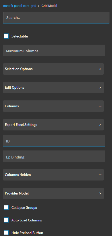

I worked in my Path A option and created a dataview with the Wizard like Path B, but can I now assign my new dataview to the Grid that was created in Path A? In looking at the properties nothing is obvious to me as to how to assign a specific dataview to the grid… I’m sorry if this is as obvious as the dumb written all over my face, but thanks for any help.

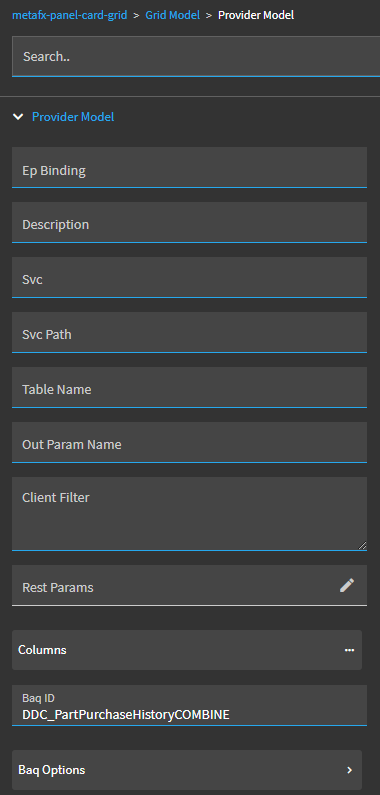

On your panel card grid… go to Data > Grid Model
Scroll down to the bottom and open Provider Model

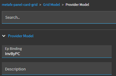

Ep Binding: The name of the DataView you created.
I’m assuming it should already contain the name of the View you created when you started Path A… so you’ll need to change it to the View you created in your “Path C” :rofl:
Description: Not sure if this is required or not… Perhaps just mimic what was already there but tweak for your new BAQ/View?
Now… Scroll down, near the bottom, you’ll see

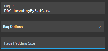

BAQ ID: You should, again, see the BAQ name you used in Path A. Change this to the BAQ from Path C.
If there are any where clauses on your BAQ, you can enter those by clicking the next setting down and going in to “BAQ Options”. You add your Where clause there, or can do a Where List if you have many different criteria.
Since you’re hijacking a previously built grid… I have to assume you have to rebuild all the columns you want displayed as the current grid will be calling out columns from the first BAQ (Path A).
So you’ll have to go back to the beginning to Data > Grid Model > Columns.
You’ll have to clear out what’s in there and then add your NEW columns back in. Build these in the order you want them displayed! You can’t really change the order later outside of deleting them and recreating them again in the order you want. So, try to get that figured out on your first pass.
You should just really need the “Field” from your BAQ, and a “Title”. If you need help on the format, it should match the Column that’s in your data view. So if you want your QuoteNum… you would enter: QuoteHed_QuoteNum
The Title is whatever you want displayed on the header row of the grid: Quote for example.

My assumption is that if it built the event for you it would be named: “Yourdateviewname_Get”
That’s what it did for me:
So, if you went into the events and did a search for whatever your DataView name was, it should show up.

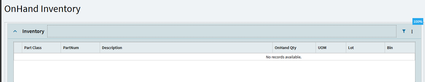

Okay… so let’s start from the beginning… here’s an example:

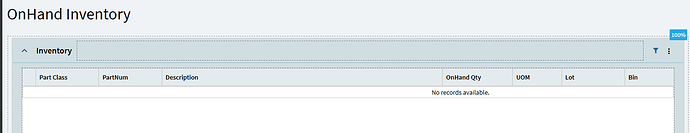

This is just a very simple dashboard I created to show OnHand Inventory “at a glance” and users can easily sort/filter by part number, description, Bin, etc.
Anyway… I’m assuming this is probably how your first grid is set up which the wizard set up for you.
I have a grid:
In the Grid Model, I really don’t have any settings:
I DID set up my columns here. But the main portion of the set up is in Provider Model. In this case, the “dashboard wizard” created a dataview and it tied that dataview to the grid here:
Down towards the bottom of Provider Model, I give it the BAQ to use.
That’s it. If you have where clauses, etc. you want to apply, you can do that in the BAQ Options here… but in this case, I did all my pre-filtering in the BAQ itself.

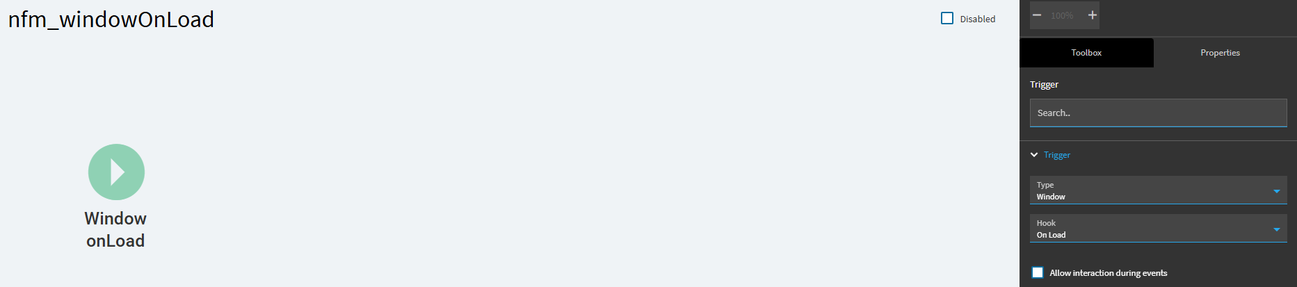

When you create a dashboard from scratch, remember that there is NOTHING there (basically). No on-form load events, not even a TransView dataview. You need to set that all up.
So, I created a Window onLoad event:
It’s basically just an empty event. It runs when the window loads, but there’s nothing in it. (no actions taking place).

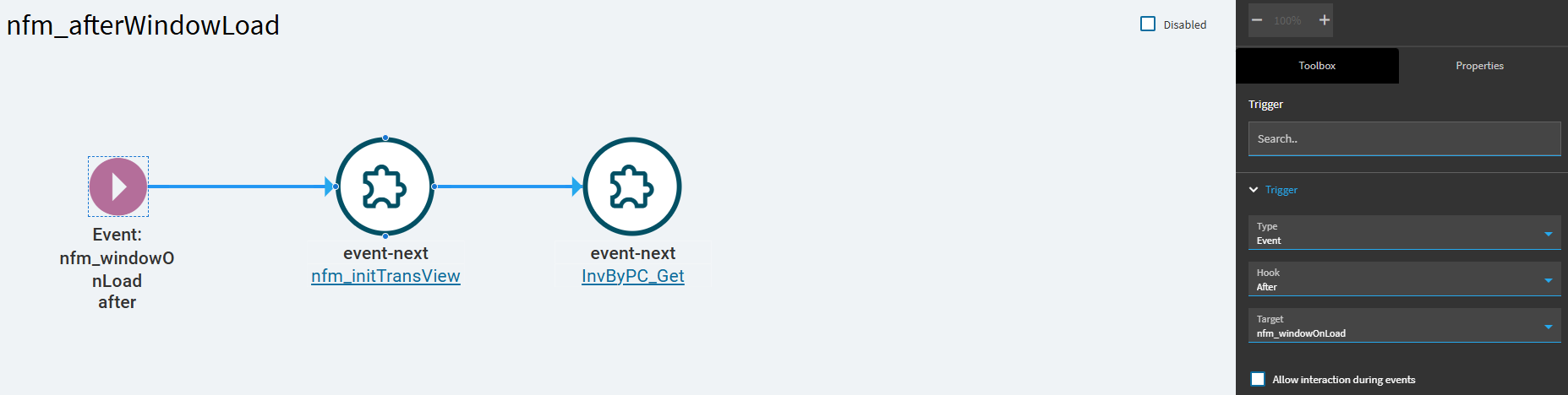

I then created a second event for AFTER Window onLoad. I may have been able to do this all in just the Window onLoad event, but I wanted to leave onLoad open in case I wanted/needed to do things later (well, earlier in this case).

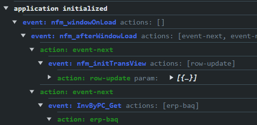

Anyway… my AFTER event looks like this:
So, after the window onLoad, it starts this event… which basically kicks off two others. One to initiate TransView (all pre-programmed apps have a TransView, but when you build your own, you have to set this up yourself), and a second to kick off the “get” event that the wizard created for me.
In Dev Tools in the browser, I can watch these events fire:
The erp-baq (get) event runs the BAQ, and it loads the dataset into the dataview I assigned earlier.

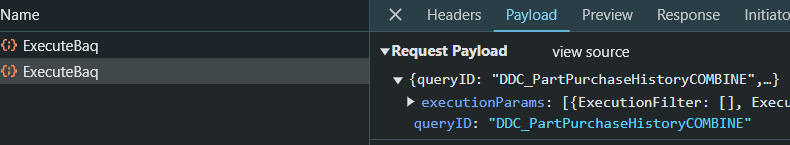

When I click the button, the slider opens… and yes, the BAQ runs automatically when that form slides open.
I can see it run in the Network tab of the Dev Tools:
Can you show me where you are in your build? Maybe we can find where it is breaking down.
Thanks for the help.
I figured it out after playing with the Kinetic course
  1. Create New Application.
    If you do the guided setup you can also define the data view here.
  2. Add Panel Card Grid to the landing page.
  3. Expand the Basic property group and set Title to something meaningful. I was using a Parts with GTINS BAQ so used that as a title.
  4. Open Data > Grid Model and set ID to something meaningful like grdPartsWithGTINS
  5. Now, go to Data > Grid Model > Provider Model and set Baq ID to your BAQ name. There is no wizard here so you either have to know it, or copied it to the clipboard from step 1.
    You can preview now to make sure it works.

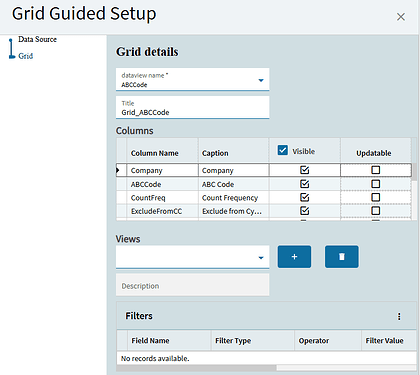

  6. Then do go back to the first level of properties and select Guided Setup. Select the data view and select which columns you wish to see.
If I created the view first then created the grid then used guided setup it failed.
It just would not load data.

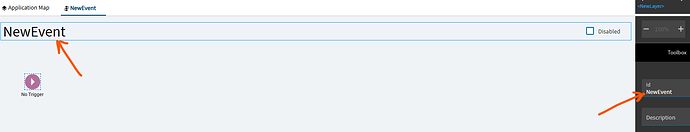

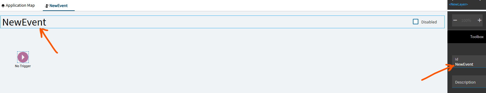

Looking through the events, it did not create a get event.
When you first create a new event, it will get the “NewEvent” name. When it opens, click the name in the designer, you should see a blue box around it to see it is selected. Then you should be able to change the name/ID in the properties area. Once you save the event, it is locked and you can’t change the name, so it is good practice to do this first.

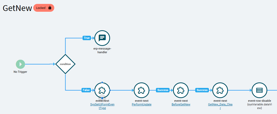

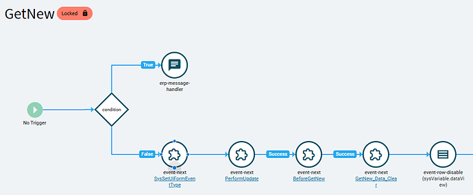

The “event-next” is just a pointer. So, in event “A”… you tell it at a specific point, to run another event (“B”). You’re not going to set any parameters for Event “B” here… you’re just telling it what event to run next (“event-next”).
Here’s an example of the “GetNew” event in Part Maintenance (Event “A”):
It has a condition, and if false… event-next: SysSetUIFormEventType (event “B”). So the application then runs event “B”.
When event “B” is complete… it comes back to event “A” and looks for what to do next. Well, in Event “A”, the next step is another event-next: PerformUpdate (event “C”).
So, it then runs event “C”. When it is done, it comes back to Event “A” and if event “C” was successful, move forward and do the next step… which is another event-next: BeforeGetNew (Event “D”).
Each of those events, B, C, D, etc. need to be created first and designed as independent events. Event “A” is just telling the application the order in which to run those other events.

The “Views” in the image below (I’m assuming is what you mean) can be set up to give your users different pre-defined/pre-filtered views they can select from.
Here’s an example from Job Entry:
The user can choose one of these default “views” to see ALL jobs, only Firm jobs, only UnFirm jobs, etc.
That’s what that portion of the guided set-up is doing. It is giving you the opportunity to build those pre-defined views upfront. You don’t have to do this step (you can always add them later if you wish).
