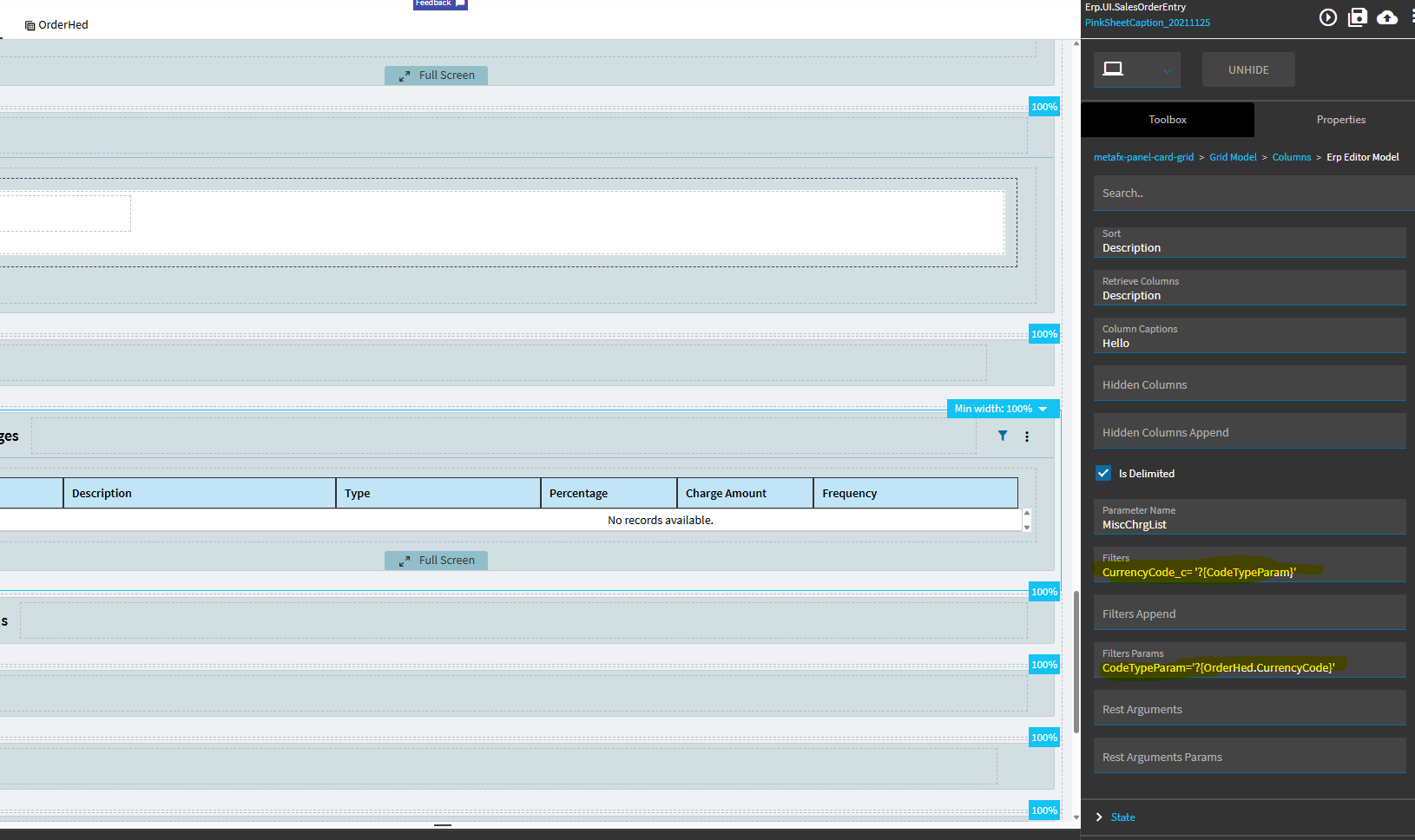

I would like to filter all miscellenious code based on the currencycode on the sales order. Can someone tell me what am I doing wrong here?

You can’t filter a combo from another dataview with those properties.
You would need to use another method such as setting the data source of the combo to be a BAQ and filter with events.
