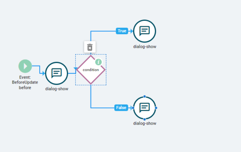

Application Studio Condition behaving strangely with Integers
The first dialog box is showing Attachments: %OrderHedAttch.count% - this works
The condition widget has “{OrderHedAttch.count}” === “0” based on the structure in the help. It always goes to the fail dialog box.
I’ve also tried removing the quotes and no dice, it always goes to the fail dialog box no matter if the count is 0 , 1 or more.

All of the following conditions always go to the failure dialog box:
“{OrderHedAttch.count}” == “0”
“{OrderHedAttch.count}” == 0
“{OrderHedAttch.count}” === 0
Trying each with both scenarios. Where the order has attachments and where it does not.
The dialog box that shows the counts is working but the condition is not.

Hi,
Try changing your condition expression like this instead:
%OrderHedAttch.count% === 0
.count and .hasRow uses %%
%OrderHedAttch.hasRow% === false
That did it. Thank you!
